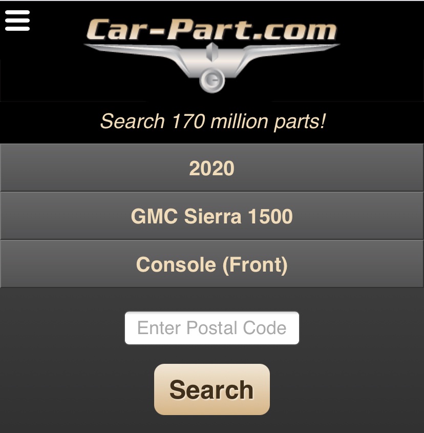

  2. I'm guessing 84816404 but I just did a search like this pic on car-part to find it. Was $75 + shipping. Prices vary by seller.

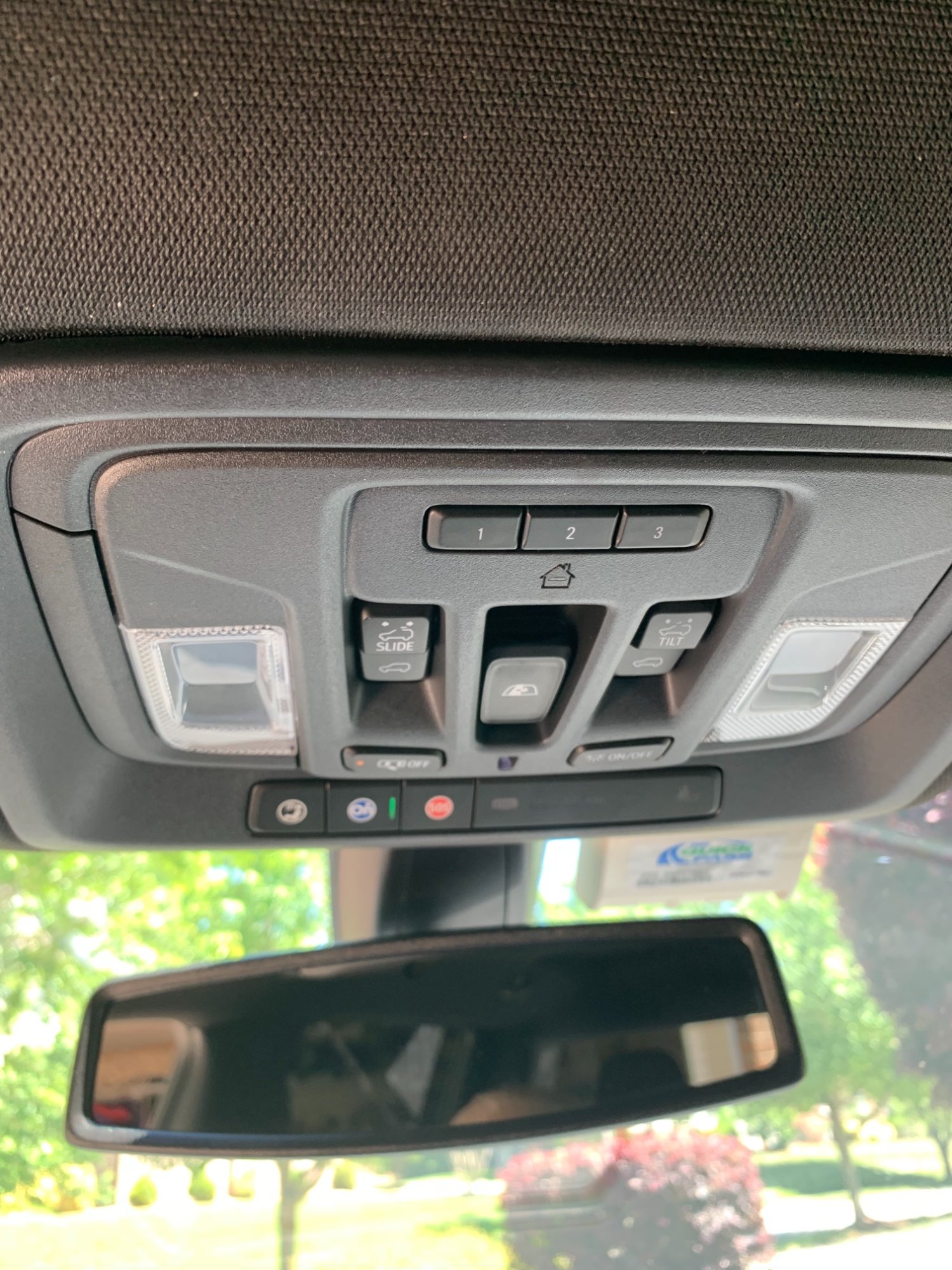

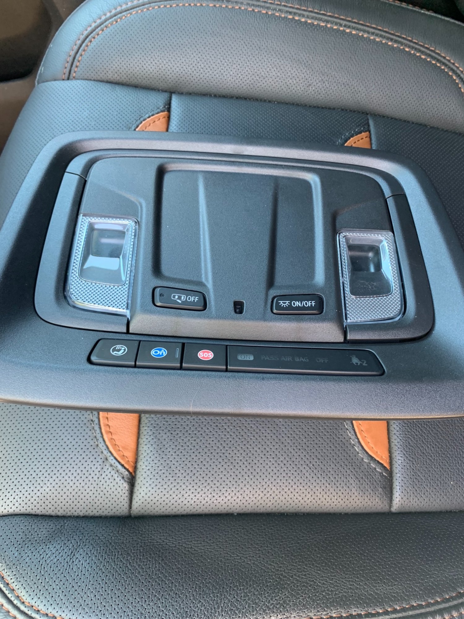

  3. I didn't take pics as I did it but the one on my seat is the old one. The second pic is the "new" one installed. It was pretty simple. 1. Pry off the 2 L shaped pieces 2. Remove 2 screws closest to windshield 3. Pull out old console (held in by 2 clips) 4. Unplug 2 wire connectors and loom clip 5. Connect wires to new console 6. Press new console into retaining clips 7. Reinstall screws from #2 8. Press in trim pieces from #1 9. Link to home garage doors Was really easy. It's a little odd to have the sunroof and rear window buttons that don't do anything but I like it better than the handheld remote and didn't want those options when I bought the truck. Bought it used from car-part.com, can find on eBay sometimes as well.
  4. Swapped out the overhead console to one with homelink garage door opener.
