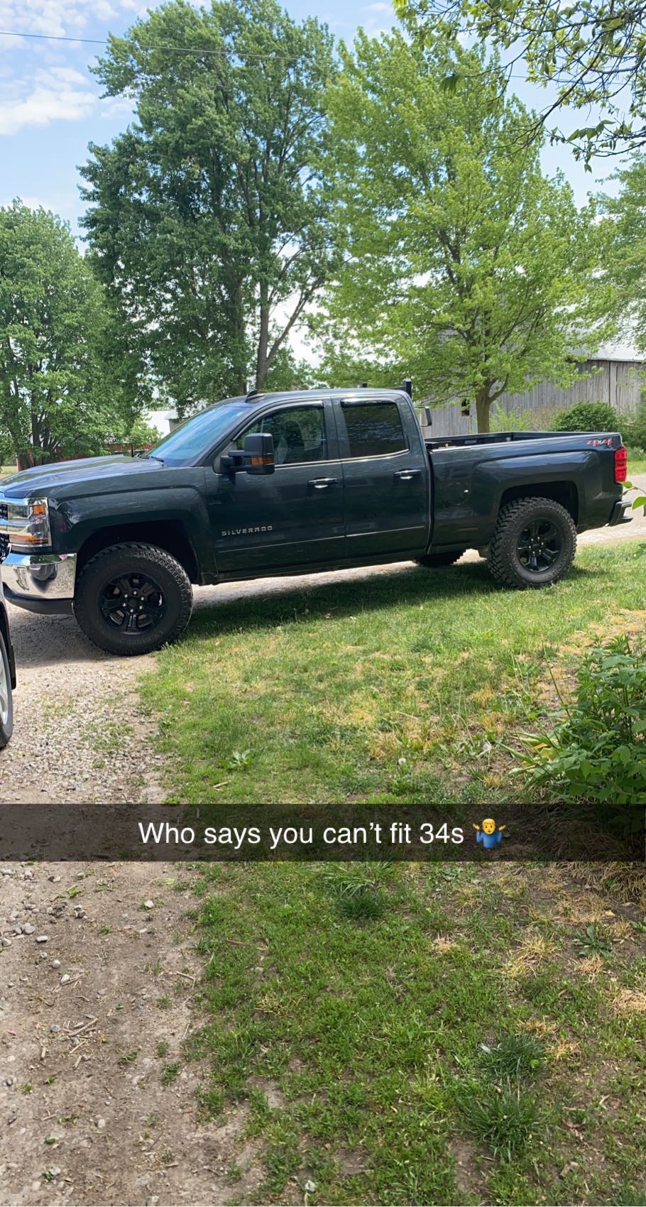

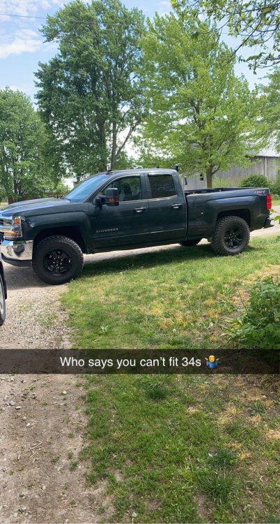

  1. I have a 2019LD Silverado 1500, with just a 2” level up front. Running stock z71 wheels, which I would assume have the same offset as your wheels. Have 295/70/18 Firestone mud terrains. No issues rubbing and you still have full off road capabilities. People will doubt it 100% but they fit and function same as stock tires
  2. Running 295/70/18 Firestone MTs on stock wheels. Have had it off road and flexing BIG time. No issues. Can turn lock to lock. I only have 2” level in the front as well. They look a lot more stuffed than they really are. I do all the same things I did with stock 265/65/18s
  3. I’ve got a 2019LD. So basically a 14-18 Silverado. Running a 2” level in the front only no rear blocks. Stock black z71 wheels with 295/70/18 Firestone mud terrains. Looks awesome drives nice. Full lock you barely hit control arms, but you’ll hit them with stock wheels anyway. Also hit back fender liner in corner. It’s not terrible. I zip tied mine back and it’s helped, still rubbing a little but u can go lock to lock. If you had not super aggressive mud tires it would be better as well. Truck sits higher, definitely feels a little slower as those are big tires, and fuel mileage has dropped 2L/100k
