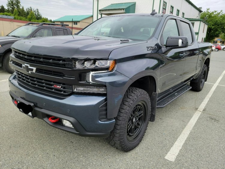

  2. I replaced my tow hooks on my RST 3.0 with the Red Forged Rough Country ones....and I ended up just cutting that pesky bolt that can't be removed with a reciprocating saw and installing a new bolt from the hardware store.....no radiator remove just a bit of aggravation....

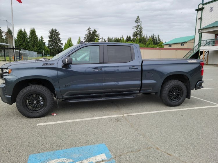

  7. On my 2021 3.0 Duramax RST 6.6 bed I have them set up at 2" setting in the front and I have a 1.5" block kit on the back...and after 20.000km ......I have a bit less than 1" rake.

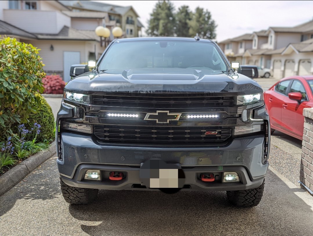

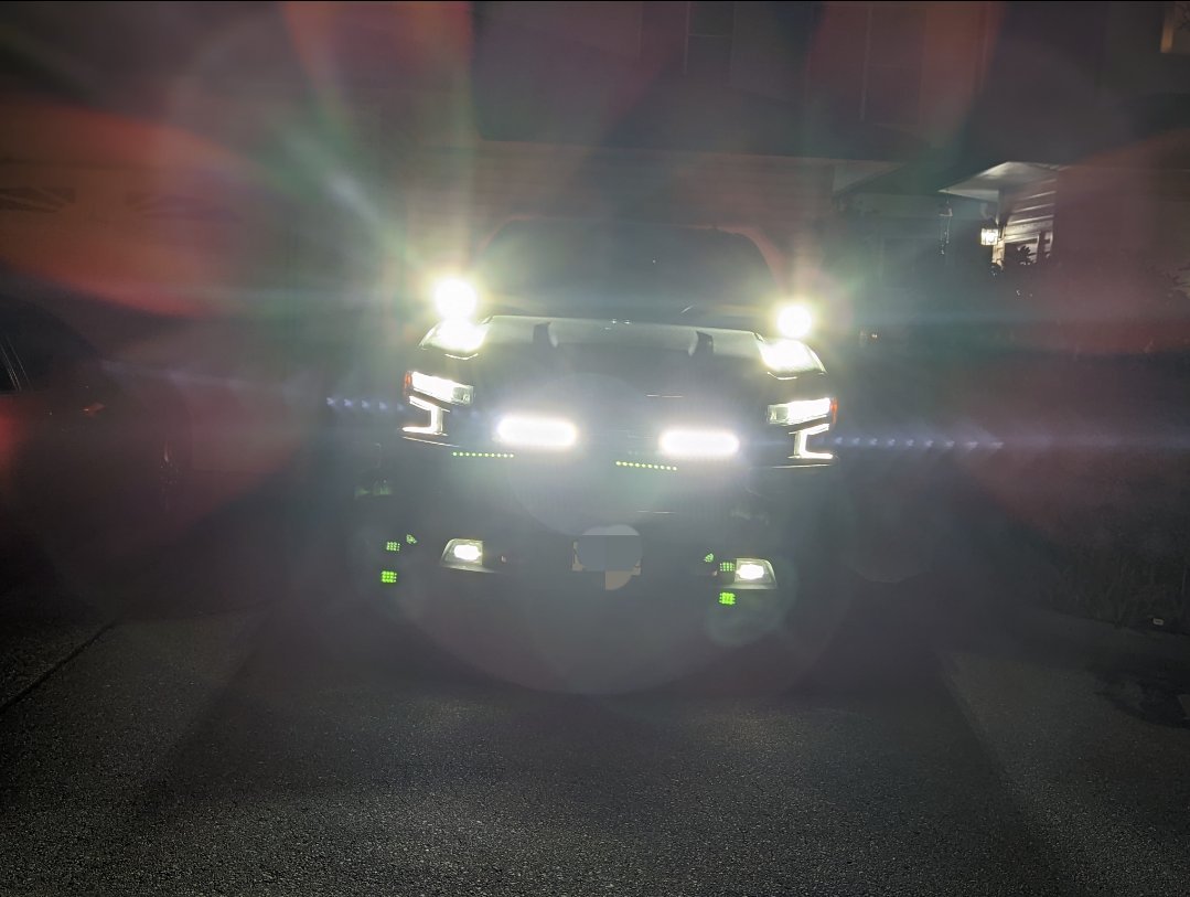

  8. Just added the Rough Country Dual 10in LED grill kit and the Rough Country 3-inch LED Lower Windshield Ditch Kit Wide Angle Osram. The Osram ones are awesome.....super bright.

  10. If you go through the process of changing them try the following ones. They are nice and a bit different... https://www.roughcountry.com/chevy-forged-tow-hook-rs132.html I have them on my RST.

  13. Hello. I did replace my tow hooks with the Rough Country ones in a 2021 Rst Duramax. Too much to type so...Watch this video and where the guy gets defeated by the bolt....you take a Saw Saw with a metal blade...cut that bolt that can't be taken out and then on re-install you just purchase a similar bolt and feed it from the other side. It's a time consuming..knuckle busting job but it can be done. Passenger side it's easy no cutting involved. Good luck.

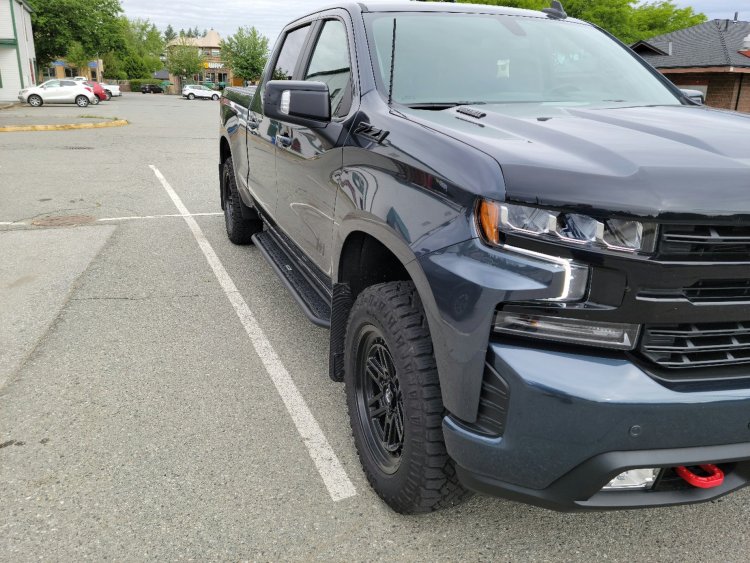

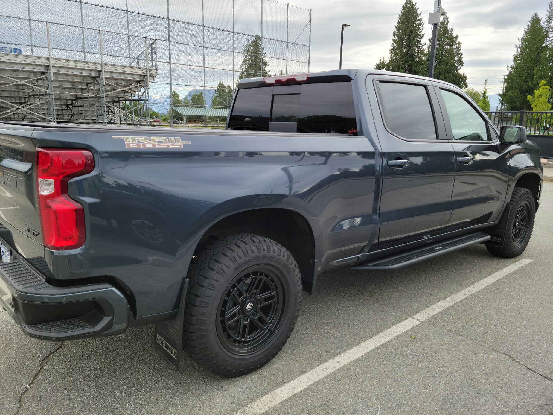

  14. All my mods to date are: - Front 2" lift from bilstein 5100 shocks. - Rear 1.5" lift kit from Rancho( that came with bump stops extenders also) plus 5100 shocks. - Go Rhino Dominator D6 side steps. - 20x9 Fuel Nitro +18 with 275 60r20 Goodyear Wrangler Duratrac (33" tall). - Front and rear Gator Back mud flaps that also came with the front fender plugs color match with the truck. - Rough Country forget tow hooks in RED ( for the extra 10hp gain..). - BAK Bakflip Mx4 tonneau cover. - Blacked out all badges using old trusted PlastiDip+Plasti Dip Glosifier. - painted the exhaust tips black with engine block high temperature paint. -AVS glue on bug deflector in gloss black. - changed the front RST grill with a all black Trail Boss grill. - removed the front bumper air-dam for better ground clearance. - Camo Trail Boss decals on the bed.
