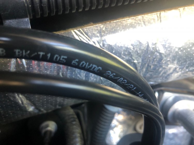

  6. Update!, THIS IS A VERY CAUTIOUS UPDATE!!!! My truck has been free of the radio problems for the last 3.5 weeks. All is good. I changed the grounding wire on the battery six weeks or so ago. Problem didn't go away after changing so thought it had no effect. But as time has gone on, i saw less and less of the self changing channels and screens. Now i haven't had a radio problem in 3.5 weeks. Ive also seen the alternator moving again from 12.5 volts up to 14.5 volts as it suppose to do. Somebody told me the trucks computer had to update the electrical power being used over time to get rid of the charging problem caused by the bad cable. Below picture on left is of the new battery ground cable installed that was bought GM original equipment, notice the writing on the shinny cable. Picture on right is old cable very dull and no writing except for CABLENA stamped into the plastic. See if your cables look like either of these. If my radio starts to act up again i will post it. very happy now!!!!
