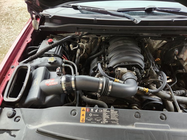

  5. I did this back in 21 and recently tried hooking up the air box and am getting MAF P0101 CEL errors upon full throttle. Anyone in this thread have any advice on how to remedy this?
  6. Back in 2021 I had a tree fall on my garage and did some minor damage to my 2017 Denali. Hood was going to be replaced so I opted for the Duramax hood. When I purchased the parts I ordered everything needed for the hood and ductwork under the hood except for the air filter box. Fast forward to the end of last year and I decide it's time to make the hood functional. I purchased a duramax air box out of a junk yard and a open box rough country cold air kit really just for the pipe and fittings. Install came out as I planned. I reused the original 1500 MAF sensor. Truck sounded great but it would throw a P0101 MAF error. I could reset this and it seemed like when I put the pedal to the floor is when it would throw the code within the first 40 miles or so. After resetting this a few times I put the intake setup back to stock and the code hasn't come back. I suspect that the amount of air the sensor is seeing is beyond the sensors max air flow limit? Any ideas if there is a way to make this work and not have the CEL. I do have the MAF sensor from the Duramax but I was hesitant to try that as I didn't want to create any additional issues.
