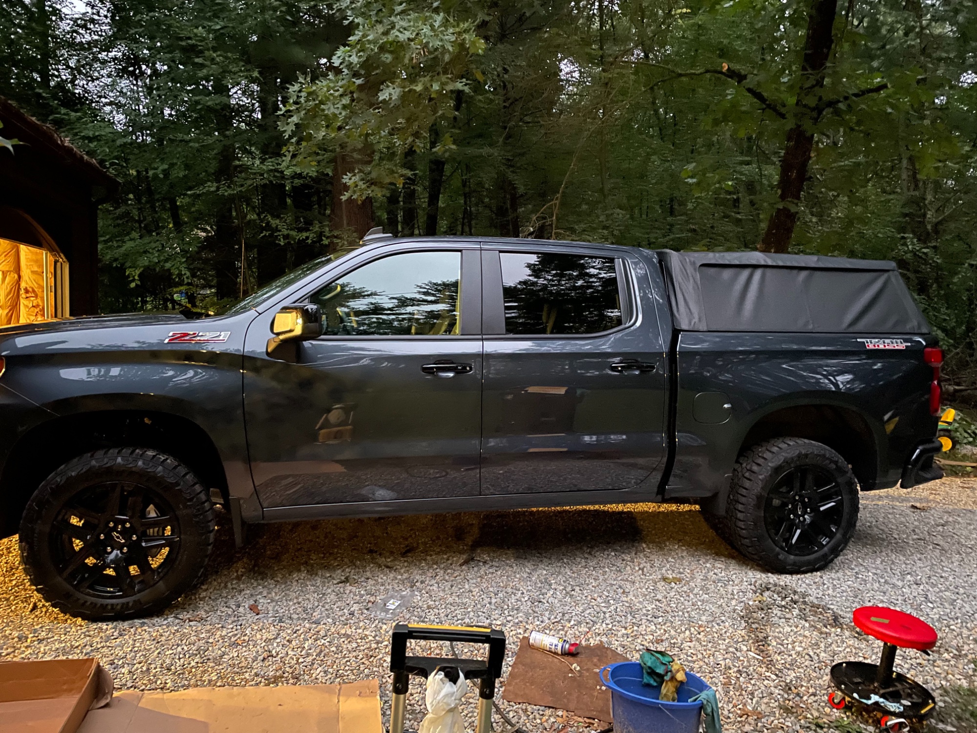

  12. Picked up my 21 LT TB 6.2 on Wednesday night, put maybe 170 miles on it and upon start up this AM was greeted with slightly rough running which transitioned to PO106, PO300 and PO506 and the truck refusing to run. Based on the symptoms and the sound while attempting to crank, like it was down compression in at least one hole - I’m betting on a valve spring. Obviously, a down new truck is a bummer. I’ll be putting around the forums here looking for some other sob stories to make me feel better. If the experienced guys here have any input or think my issues may be less severe - we’ve got until Monday at the earliest to argue about it when the dealer should dig into it. Since pics get peoples motors running, here’s the one I have after getting the topper installed the day after I picked it up - Thursday
