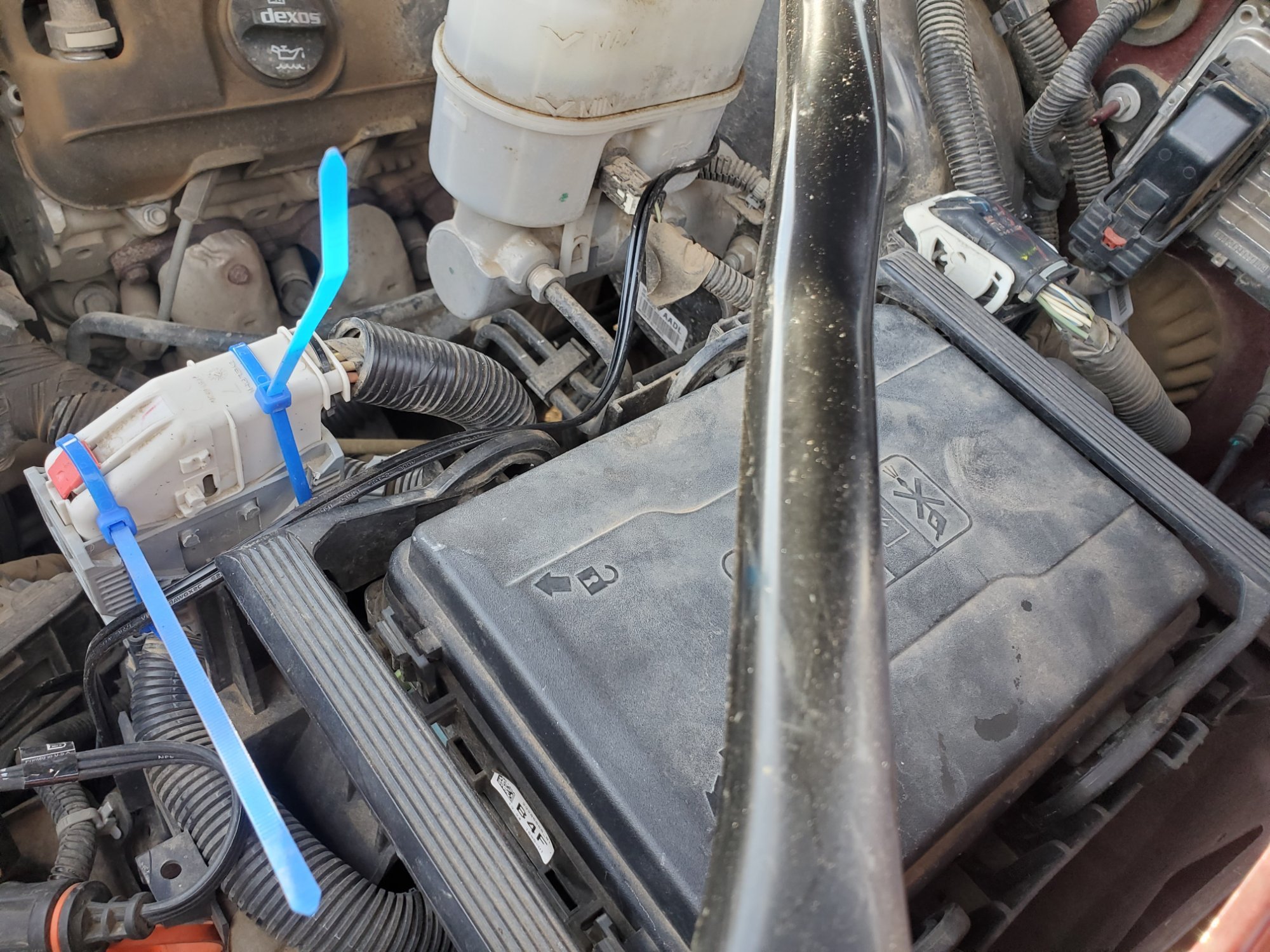

  1. Hi. I just finished dealing with a no crank issue on my 2015 Denali (6.2). As part of my diag I went to unplug / plug back in several fuses, relay, and wiring harness connectors. My issue was ice blockage in the starter solenoid, however, when I got the truck running and cleared all the loss of communication codes, I was still having issues and messages exactly like you are describing. I managed to bugger up one of the wiring harness connectors with the lever lock. I checked it 15 times and declared it good but was still having issues. I squeezed it together with my hand and poof, everything came back. I swore it was seated properly but it wasn't. It's still cold out and I just came in to warm up. I'll get back out later and take a picture for you. But the connector on my truck that was the offender is on the driver's side, to the front and passenger side of the main fuse box under the hood. The plastic lever latch broke and blocked the connector from fully seating. I put wire ties on it for now.

  3. Update: It got up to 25 degrees today and the wind isn't blowing so I was able to be outside long enough to drag the floor jack over to where the truck is parked, get the front in the air and put an electric heater under it. It starts and runs now. It progressed from no crank to intermittent crank, then reliable crank, no start to starting right up. There was a point where I heard a scraping sound coming from the starter area, to me it sounded like ice chunks scraping on the bendix. Granted, I was assuming ice blockage in the starter solenoid as the culprit so I am biased to make that assumption. So I'll order an updated starter and swap it out in the near future. In my short trouble shooting efforts in the cold, a connector I had triple checked and declared good turned out to not actually be fully seated and I had to sort through. I was getting transfer case, transmission and steering system loss of communications for a bit. Trying to undo one of those big connectors with the lever lock was actually a bad idea when it was -25 as it is now broken and zip tied together. Now that I drug the floor jack to where the truck is parked, if it happens again I can quickly get a header under it to thaw out the starter. Hope this helps someone else and I'll update this tread with any new developments. Lessons learned: when it gets that far below zero, simple things become difficult and durable things shatter when you touch them.
