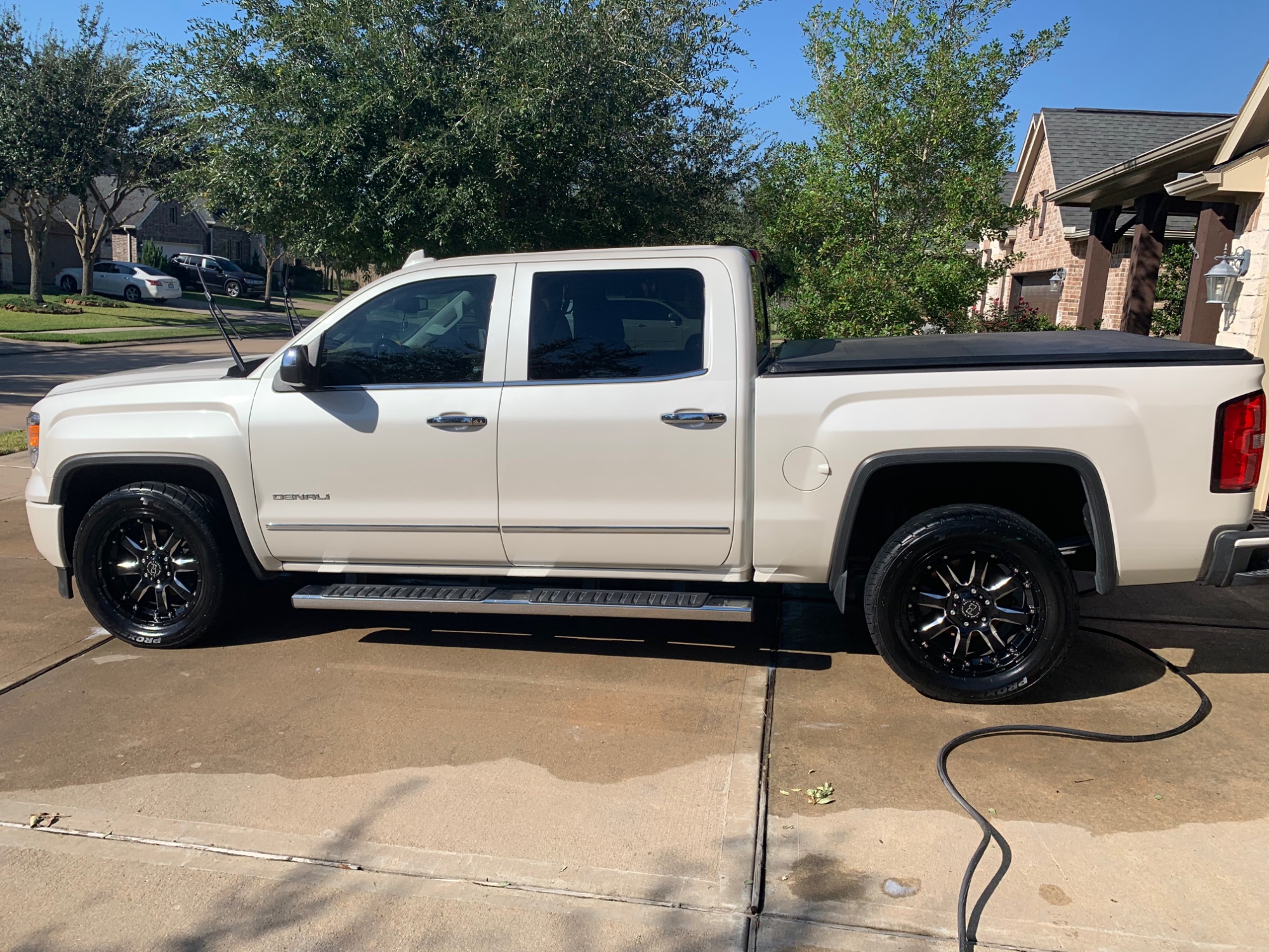

  4. Been researching through the forums but it seems not to many have dropped their truck running a 305 tire with a 4/6. I was curious to see if anyone has experience with a a wheel set up of 305/50R20 - Rim - Black Rhino 'Sierra' 20x9.5 Offset 12. How would this work out with rubbing and drivability.
  5. I have a 2015 Sierra Denali with the Magnaride. It is towards its end of life and set between two options. 1. Replace the Magnaride with OEM system and go about the days and drop the rear to match. 2. Switch to a dead system and commit to a 4/6 drop. I have a few questions. Are there recommended kits that delete the magnaride. I have found 1 in Canada that runs 1500 in Canada. Seeing I am in Texas not the most ideal location. Also what kits are out there for the 4/6 drop. If anyone wants to send Pictures of a Sierra on 20's with the 4/6 would help. I am leery to do a drop with 20's as I am not sure they will fill the wheel well properly. Link provided to what I have bookmarked. https://magdelete.com/shop/ols/products/2015-2018-gmc-sierra-1500-bilstein-magneride-delete-kit/v/201-201-GMC-SRR-201?gclid=Cj0KCQjw8eOLBhC1ARIsAOzx5cFduv-MPt-IEIldiP-se-Zg2T61VcfwHWLd5pI5gvjQp8yZLWX2UogaAq_cEALw_wcB Not sure which one. https://switchsuspension.com/lowering-suspension/lowering-kits/gmc-lowering-kits/sierra-1500-14-18-lowering-kits/
