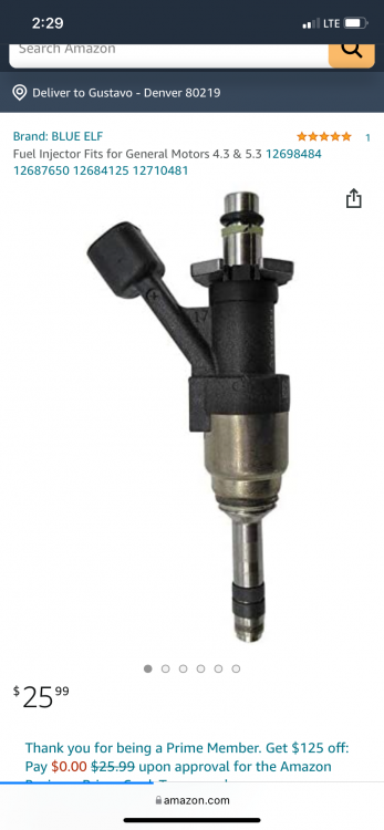

  11. Sounds good! Well I tried ordering some OEM ones from online but I called two different dealerships and they gave me two different part numbers. One is 12701381 and the other 12710481 and I only found these two oem injectors so I don’t know which ones would be the ones to work.
  12. Awesome thanks man, I’ll try to get it scanned asap. Am I able to get away with buying injectors from somewhere online? Or do they have to be from the dealer?
