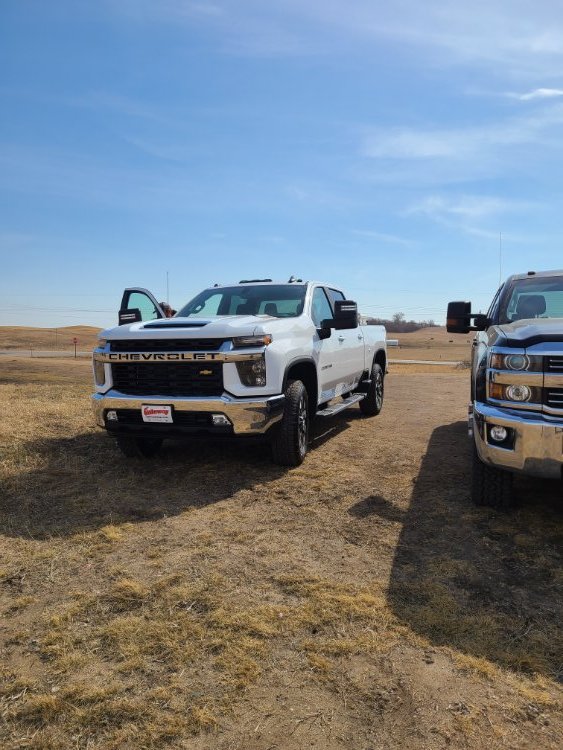

  1. No I didn't bang anything up, I was tying to get back on the road. I was still moving and I did not hit anything. Follow up to this post I brought my truck to another dealership and they took a little more apart. discovered that the bearings inside my transfer case failed and caused the Ujoint to fail. They are going to cover it under warranty.
