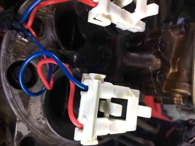

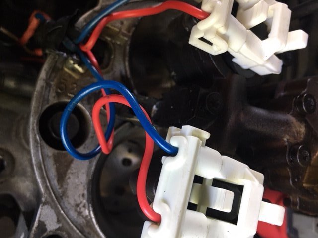

  3. It looks like the injector is bad. I measured the resistance and it is less than .5 ohms. The good one is 15 ohms. I also found out that you can connect the injectors with either plug. Also, the individual injector connectors themselves are not polarity sensitive. So, I swapped the plugs and the passenger side would still not work. The driver side still worked. So, I can eliminate the ECM and wiring. I order a TBI gasket set and a new injector. Should be here in a day or 2. I think I may just remove the complete TBI and work on it off the vehicle. Thanks for all the help. I will let you know how it turns out.

  12. I removed and cleaned the IAC. Disconnected the battery to reset. Same problem. I will drive it around tomorrow and see what happens. I didn't think there was too much carbon built up? The throttle top side plate is clean. When I was trying to figure out why it wouldn't fire, we sprayed quite a bit of throttle cleaner. Also, that is when we checked the injectors spray. All that seems fine. See attached photo's
