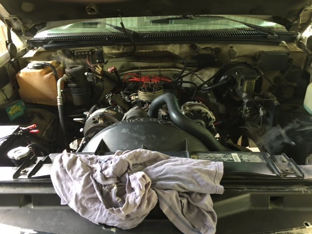

I removed and cleaned the IAC. Disconnected the battery to reset. Same problem. I will drive it around tomorrow and see what happens. I didn't think there was too much carbon built up? The throttle top side plate is clean. When I was trying to figure out why it wouldn't fire, we sprayed quite a bit of throttle cleaner. Also, that is when we checked the injectors spray. All that seems fine. See attached photo's
