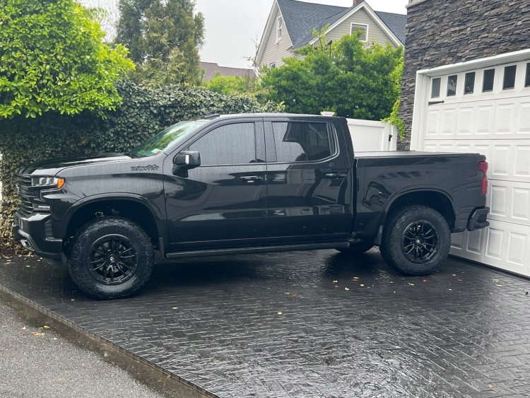

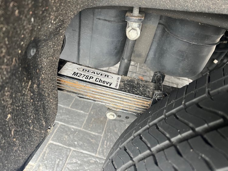

  15. I just installed Fox 2.5 Coil Overs with Reservoirs all around with Icon Upper Control arms along with the Deavers Full Rear Leaf Springs in the rear and I’d be willing to bet its a better set up than the Chevy ZR2 set up.
  16. •Fuel Rebel 20 x 9 with 0 Offset •Toyo Open Country A/T 3’s 325/60-20 •Fox 2.5 w/Reservoir Front and Rear Leveling Kit •Icon Upper Control Arms •2” Block in the Rear •Deavers Full Leaf Springs with the 1.5” lift of the springs taken out by Deavers (maybe should have left it to avoid using the 2” block). •Front and Rear Hellwig Sway Bars. Some minor inner wheel well trimming with mud flap trimming and 1/2” hubcentric wheel spacers but all else is fine. Full turn lock to lock has a slight hit of frame
  17. Getting 35’s with new Rims soon to fill those wells a little better
