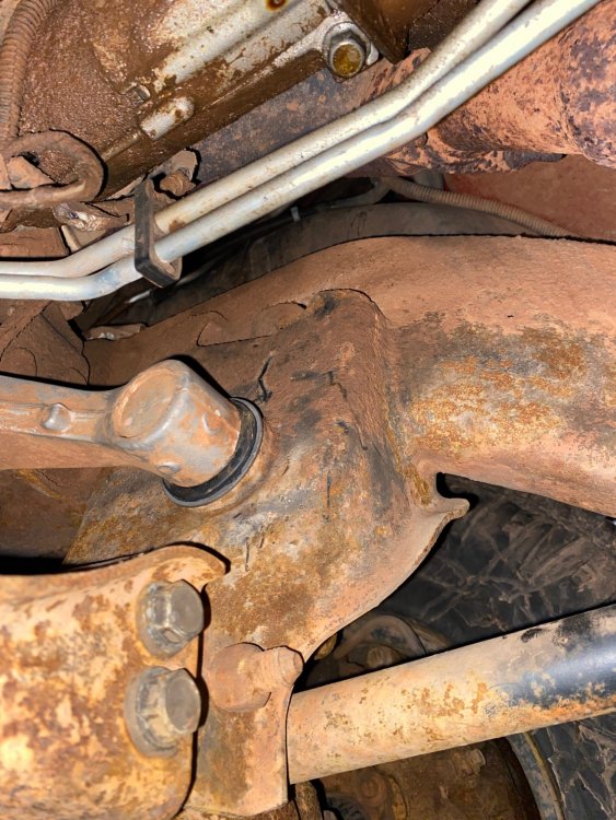

  1. What you have posted is control arm Bushings. I’m looking for the front diff bracket bushings. The two bushings in the picture. I got this from energy suspension but i cannot find a bushing kit to fit a 2002 2500HD, only 2007 and newer.
  2. I’m hoping someone on here can help me out. I have a 2002 2500hd 4x4, I did a 2wd to 4wd conversion and the last piece of the puzzle I need is the bushing in the frame for the front diff bracket. My local dealer gave me two gm bushings number 15962664, but after going to install them I realize the two different holes in the frame are different sizes. That bushings they gave me, one fit the rear mounting hole but is too big for the front hole. The dealer and any parts stores are no help to finding a source to get this bushing. So im looking for a part number of the bushing that I need. I’ve attached pictures to help explain. thanks
