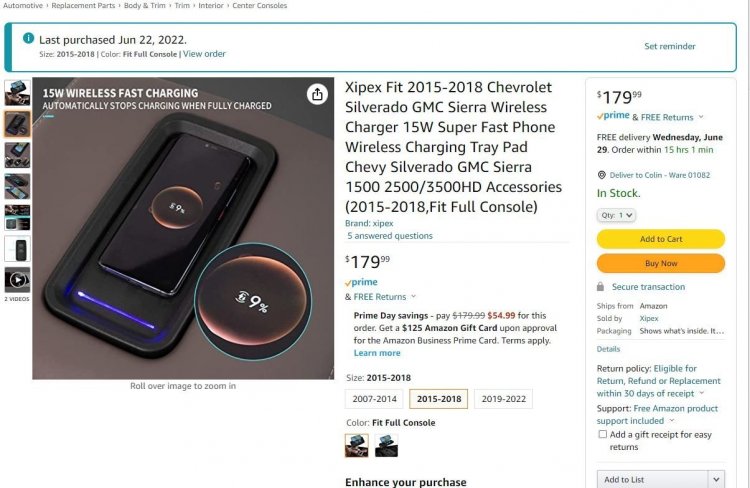

  2. I just got this in over the weekend, gonna try to install it tonight. I'll let y'all know how it goes.
