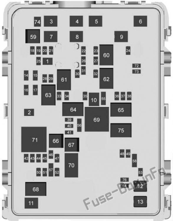

  4. I replaced the #4 and #8 (in picture) J-Case fuses for instrument panel that were there when I bought vehicle. Both were 60amp. Should I replace with 10amp, or is that what is called for? Can't find that info anywhere other than this thread. I will check out the ground issue today...Thanks for the reply newdude!
  5. New to forum and I'm sure this question has been asked but...Just bought a 2015 Denali HD w/37k miles. 5 days in and my instrument cluster went out. Both dials and digital display. It seems the radio is effected also as it does not respond to touch or pre-programmed stations only dial works to change stations and screen shows Sirius home screen only. Additionally temp shows as Celsius. I replaced both 60amp fuses for instrument cluster twice and within a day or 2 panel is out again. Any suggestion? TY
