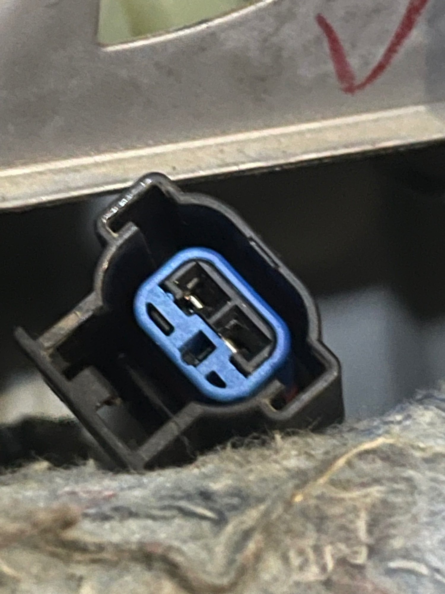

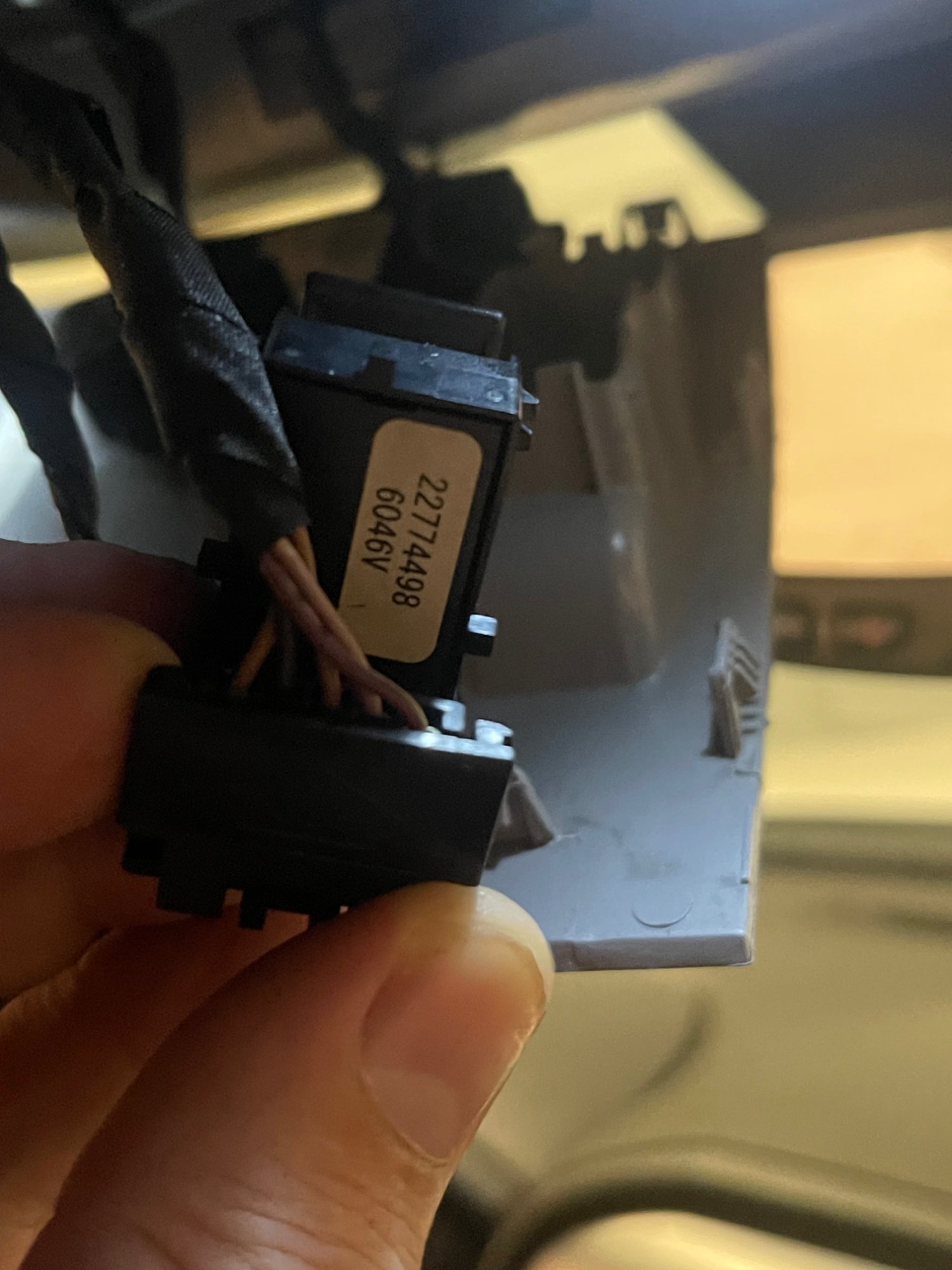

  1. I am having a similar issue, I have power going to the switch which I thought was the issue so I replaced it and come to find out it was not the problem. I looked at my fuses and I think my trucks fuses are labeled wrong because I pulled the fuse that says goes to the rear window but it still shows power going to the switch when the fuse is out. I included a picture with an arrow showing the fuse I took out on the passenger side door fuse block. Can you tell me is that the correct fuse anyone else has tried or is there another fuse or is there maybe a relay that went bad? I have pulled the rear seat and tried testing the plug going into the motor and it has no power because that was what I was going to replace next or should I try the wiring harness first? Was the wiring harness hard and expensive to replace? if anyone can help me with this I would really appreciate it.
  2. I cant figure out why my rear window quit working. I have checked the fuse panel and I think my fuses are label incorrectly and or I am missing fuses. I checked the switch in the ceiling and only 1 of the wires going in has power to it no matter what way the switch is pressed. I also checked the black plug going into the rear window motor and there doesn’t seem to be power going to it. Can you tell me if the switch is working correctly, is that how it is supposed to work? Also I took out the fuse that says is for the rear window but there is still power going to the switch when I remove that fuse (see red arrow in photos) the next thing I was going to look for is the relay and replace the switch. I would think the switch would have power coming out of it when the switch is pressed or pulled and I don’t have anything just the power going in on the far right wire. I hope that makes sense.
