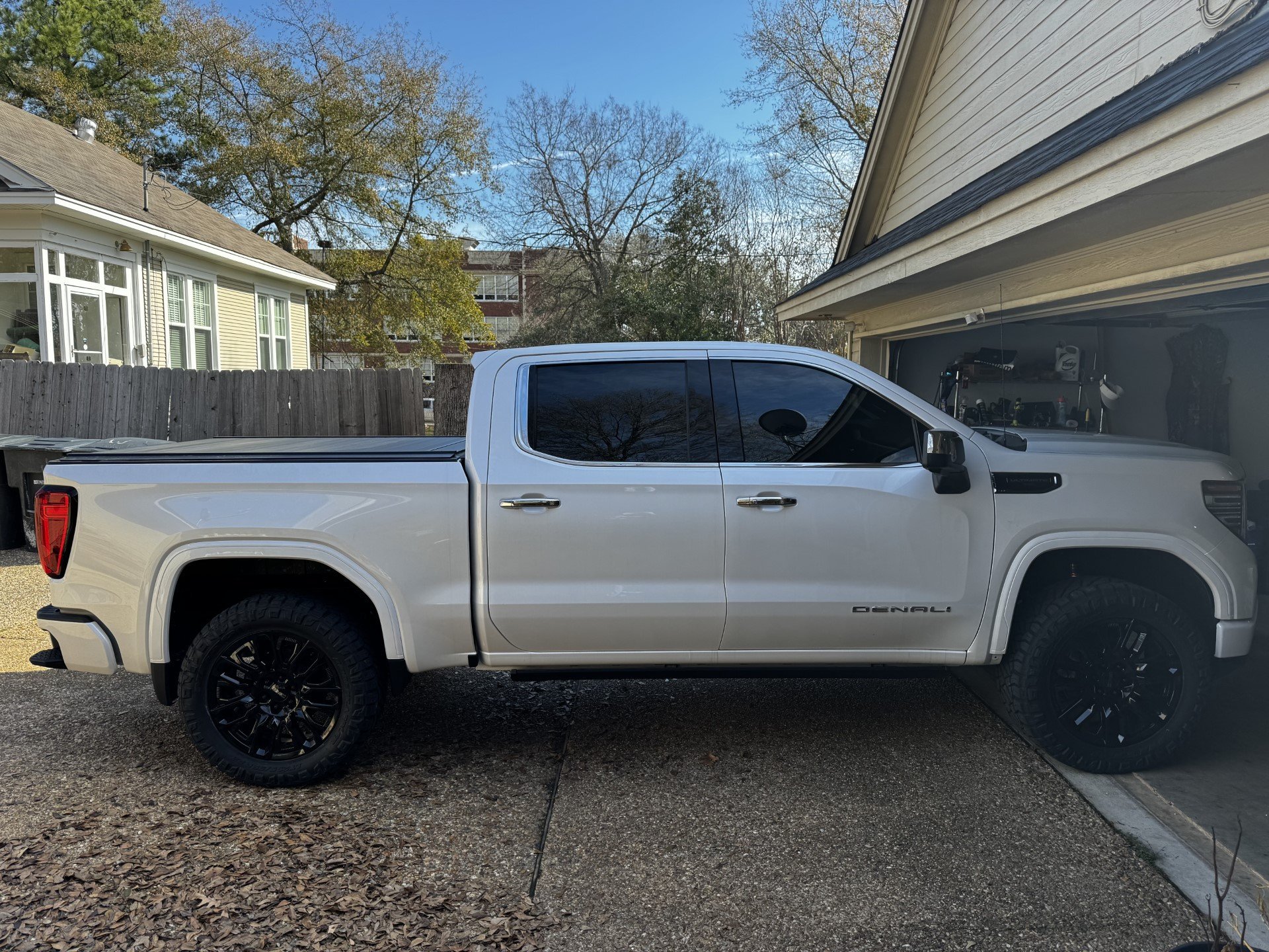

  1. The cognitive 3” is a coilover and for the rear I replaced the spring leafs to aftermarket and set them at 1”. Since new UCA’s came with the kit, I’m pretty sure I would have had more issues if I would have kept the stock UCA’s.

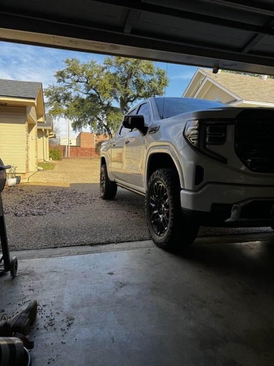

  2. 3" cognito level with 295x55x22 ridge grapplers. 1/4 spacers needed and minor trimming on front bottom bumper. Angled the cut and now no rubbing issues.

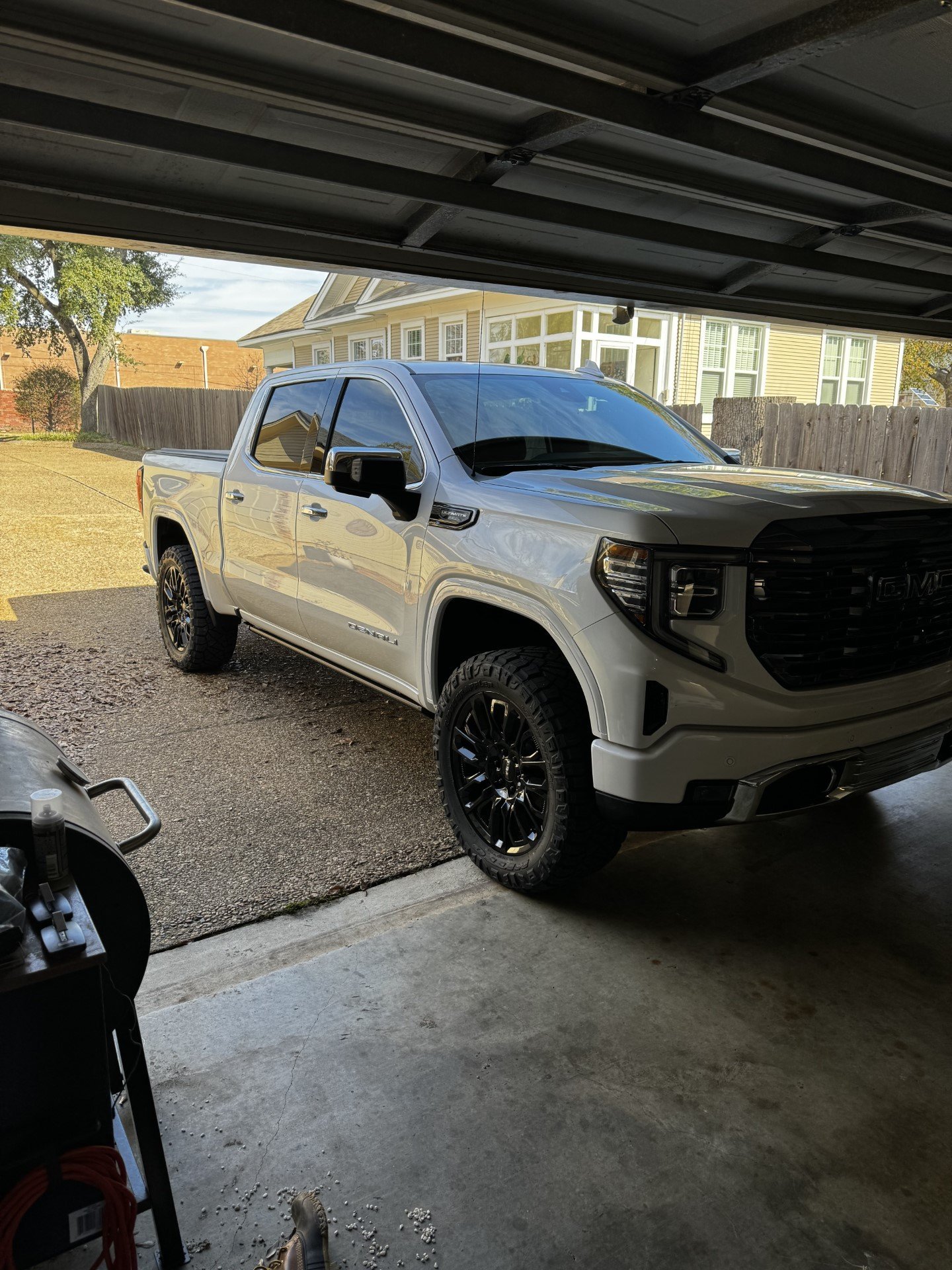

  3. Got everything done and I couldn’t be happier with how it turned out. Build list below. Cognito 3”level with Elka 2.5 shocks Deaver mini spring leaf set to 1” (replaced stock) front windows and windshield tinted Color matched wheel arches(white frost) AMP research power steps Retrax pro power tonneau cover Gloss black stock Denali ultimate wheels powder coat 295x55x22 Nitto Ridge Grappler Tires fit but rub turning left with no cutting/trimming— I couldn’t handle rub so cut front bottom bumper corners. Not rub at all
