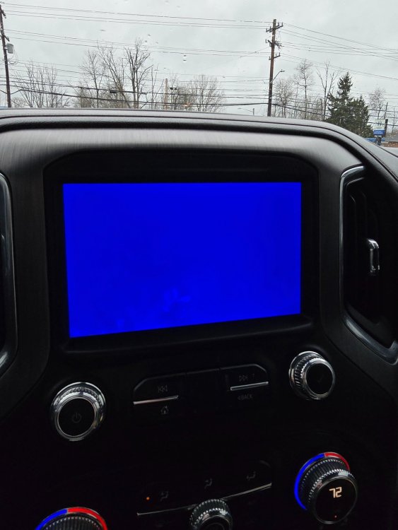

  16. I believe mine said key fob programming. I just went and disconnected the battery as soon as I saw it happen. My running boards get all whacky afterwards too. I guess some people have this happen and come back later and it's "normal". Each time it's happened to me I wasn't home so I didn't have the luxury. I put a 10 mm socket in the center console after it happened the second time. I never expected it to happen again, but I was definitely wrong. I hope they can figure it out tomorrow. Do all of your cameras work? My front is out all the time. Usually the others work. I got the weird blue screen once and it hasn't happened since.

  20. This has been happening to my 2019. It's also had some camera issues where they completely cut out and gave me a bright blue screen. It was on a heavy rain day where I'd been traveling 70 mph for 40 miles or so, not that that's an excuse for them to stop working altogether. My main concern is the key fob issue. I'm afraid of it not working when I disconnect the battery at some point. Did you ever figure out what it was?
