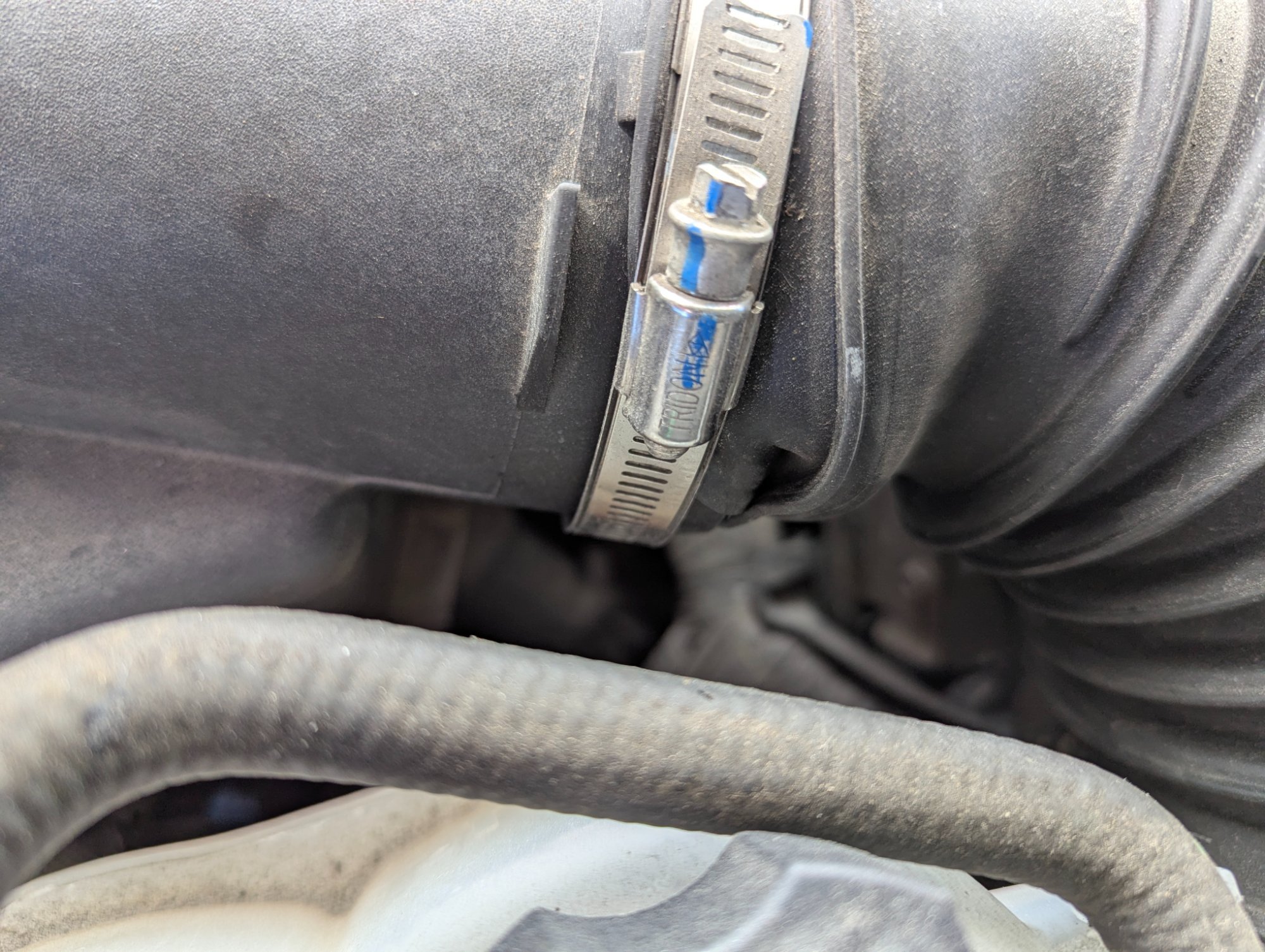

  1. Well the mystery has been solved. It was found that the when the air filter was inspected at the last service, the hose was not connected to the air box correctly there was an air leak going by the mass airflow sensor. Couldn't see it from the front side of the engine.....
