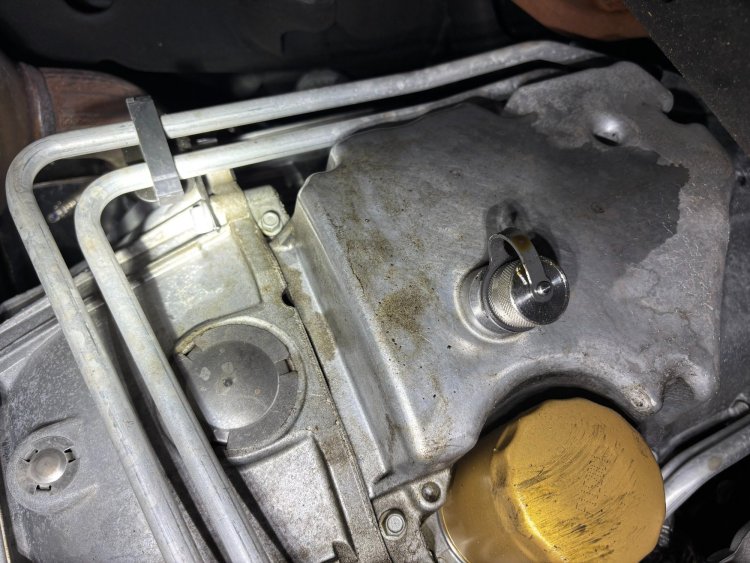

  2. Alright so quick update, I swapped out the ValvoMax bolt for a new Dorman Bolt with the rubber washer/gasket and that did the trick. Also I did an oil change but not the filter, adding the full 8 quarts. The oil level sits right at the top the hatches on the dip stick, almost like GM designed the L8T for fleet use, lol.
  3. I went out and checked it out, no clear signs of fresh oil leaking above the drain plug, it's all old oil, probably from when a tech doing the oil change wiped it down with a oil soaked rag or being messy with the filter. No fresh oil there. However you were right, the ValvoMax is leaking at the threads, not dripping but definitely seeping fresh oil. I reached out to them and will probably just change back to a regular bolt now.

  5. Doing a test on that, it's the ValvoMax Oil Drain Valve, I don't think it's leaking, I think it's just a drop or 2 of oil from the last oil change running down. But I will keep an eye on it.

  8. I've heard of the oil consumption issue with these motors and I check my oil regularly, currently at half way up the cross hatches after checking overnight with a cold engine at 85% left on the oil change, which seems normal to me. Also here is a pic of the underside of my engine, seems like some weeping oil, but I am no expert, what do you guys think? It's looked like that since I bought it.
