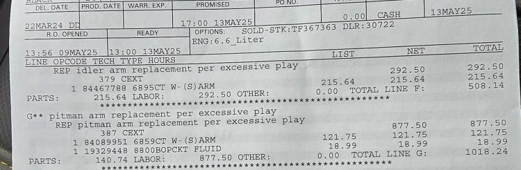

2024 Silverado ZR2 2500 6.6L gas engine failure
Eric.V replied to Eric.V's topic in 6.6L Gas V8 (L8T)
The idler arm and the pitman arm were replaced due to excessive wear. The steering feels like new and the steering wheel is finally straight!!! -

My friends I am here to update anyone who cares to read the ongoing soap opera my truck has put me through. Engine and transmission replacements have been holding up just fine thankfully. The truck is on its 4th radiator. #1 was replaced when the engine blew #2 was replaced when the transmission blew #3 was the replacement for #2 and it failed at the dealership when they filled it up with coolant and found a crack on it under pressure. The radiator on the truck now is its 4th one. Now I have some info that may or may not shed some light into some issues other HD owners may be experiencing with their steering. I apologize in advance for the novel, however I have had my fair share of issues with my particular 24 unit. From engine and transmission replacements to electrical and radiator replacements.. Since I purchased my truck I have had issues with the steering wheel not being "straight" when on a straight road. I always had to drive with it turned slightly to the left. Took it in a couple of times and the dealer would correct it as much as possible but it was never found to be enough of a problem to actually take the steering components apart to figure out the issue. On dirt roads or rough roads I have also noticed a slight "binding" feeling when turning at low speeds. However since this truck is my first HD truck, I figured that's just how HDs felt given that the dealer saw no issues with it. On wet roads or slippery surfaces while turning the steering wheel at 0-5 mph the tires and the steering wheel would vibrate and chatter. Again, I figured this was normal as the dealer had found no issues with the truck. Now thinking back at this I am realizing how silly I was for thinking that .. My father has a 24 HD gasser as well but his is a GMC AT4 and mine is a Chevy HD ZR2. I drive his truck often and I did not notice these symptoms on his truck. Again, me being silly thinking the "issues" on my truck were normal due to the dealer telling me everything was fine, I figured my truck did what it did due to the ZR2 suspension and bigger tires from the factory. Over time this issue became more and more noticeable and I am finally at the point where it is clearly not the "crowning" of the roads that is causing me to have to steer left to go straight. Took it in today for the tailgate recall, oil change, tire rotation and balance and also to have the alignment looked at again. Well the service advisor called and informed me that the tech could not for the life of him get the steering wheel straight. They took a deeper look into the steering components and found the pitman arm had an abnormal amount of play. The truck now has 36k miles on it and thankfully the extended warranty I purchased covers this. I will report back once it is replaced to see if that fixes the issues I have always had with the steering. -

Eric.V started following Feeling Vibration and Jiggles in 2024 HD Gasser Steering Wheel
I have some info that may or may not shed some light into some issues other HD owners may be experiencing with their steering. I apologize in advance for the novel, however I have had my fair share of issues with my particular 24 unit. From engine and transmission replacements to electrical and radiator replacements. It's on its 5th radiator. Don't get me started on that.. Since I purchased my truck I have had issues with the steering wheel not being "straight" when on a straight road. I always had to drive with it turned slightly to the left. Took it in a couple of times and the dealer would correct it as much as possible but it was never found to be enough of a problem to actually take the steering components apart to figure out the issue. On dirt roads or rough roads I have also noticed a slight "binding" feeling when turning at low speeds. However since this truck is my first HD truck, I figured that's just how HDs felt given that the dealer saw no issues with it. On wet roads or slippery surfaces while turning the steering wheel at 0-5 mph the tires and the steering wheel would vibrate and chatter. Again, I figured this was normal as the dealer had found no issues with the truck. Now thinking back at this I am realizing how silly I was for thinking that .. My father has a 24 HD gasser as well but his is a GMC AT4 and mine is a Chevy HD ZR2. I drive his truck often and I did not notice these symptoms on his truck. Again, me being silly thinking the "issues" on my truck were normal due to the dealer telling me everything was fine, I figured my truck did what it did due to the ZR2 suspension and bigger tires from the factory. Over time this issue became more and more noticeable and I am finally at the point where it is clearly not the "crowning" of the roads that is causing me to have to steer left to go straight. Took it in today for the tailgate recall, oil change, tire rotation and balance and also to have the alignment looked at again. Well the service advisor called and informed me that the tech could not for the life of him get the steering wheel straight. They took a deeper look into the steering components and found the pitman arm had an abnormal amount of play. The truck now has 36k miles on it and thankfully the extended warranty I purchased covers this. I will report back once it is replaced to see if that fixes the issues I have always had with the steering.
