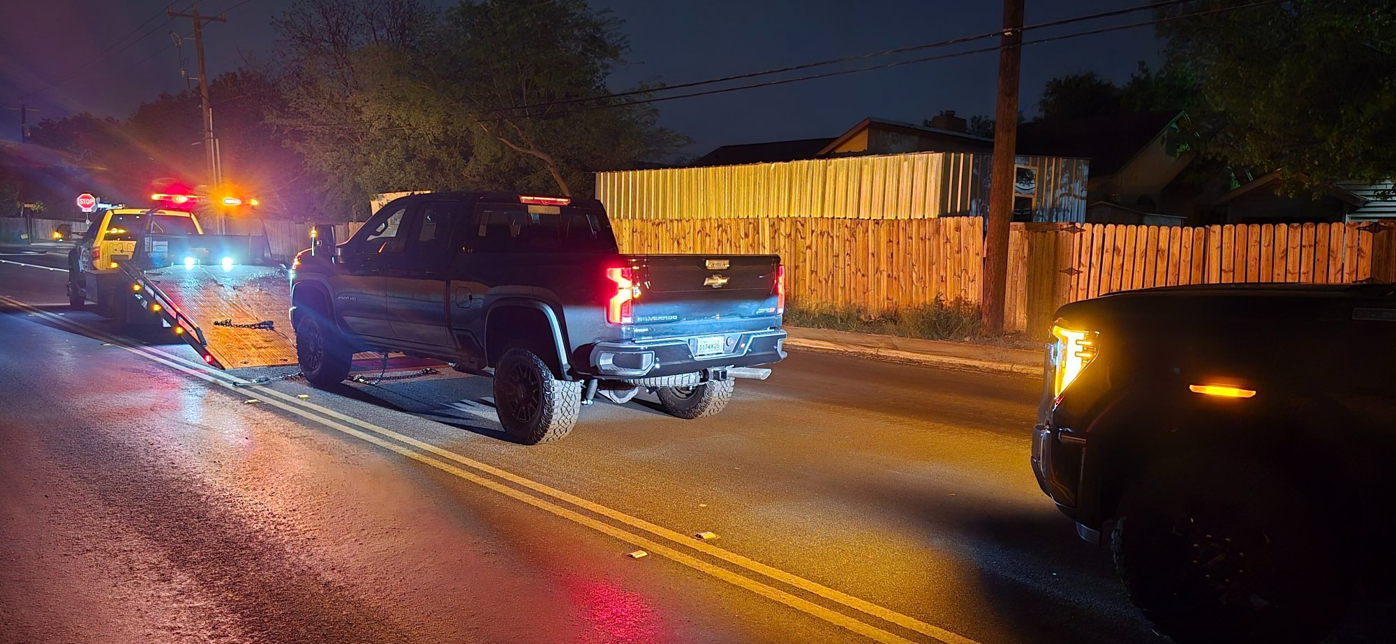

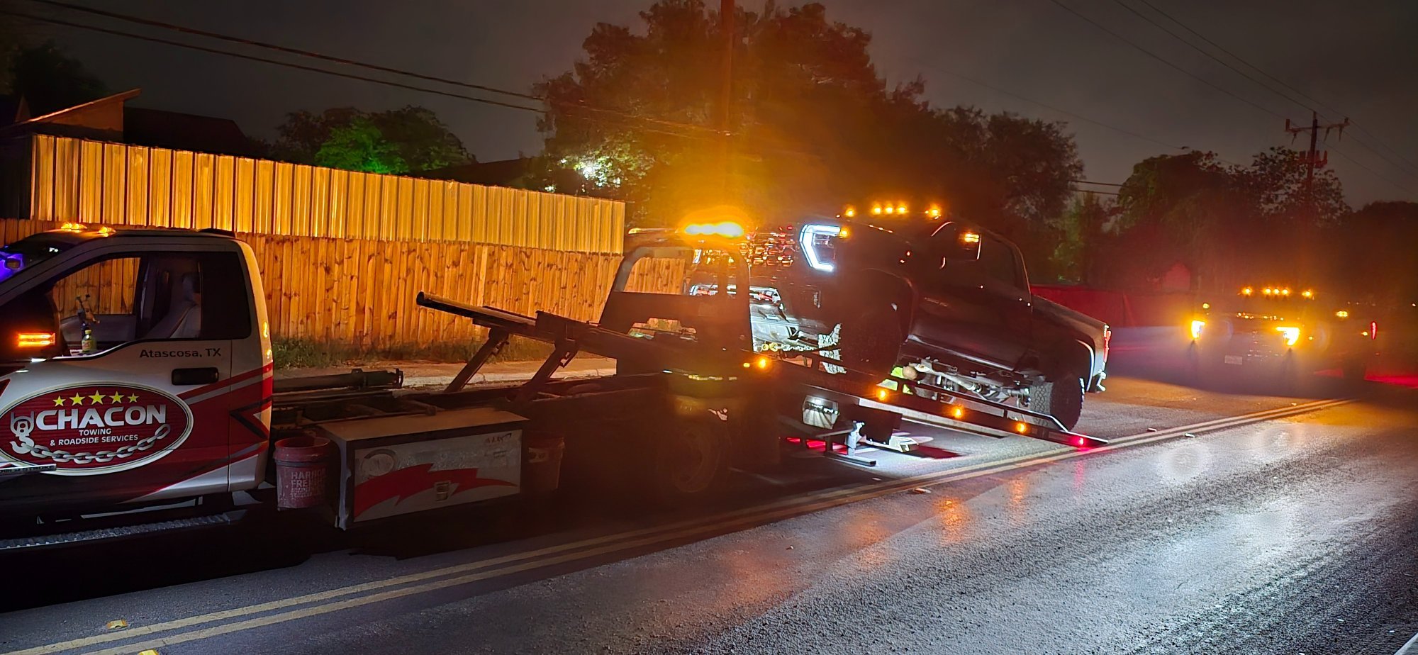

To simplify the ongoing situation with my truck here is a run down for anyone who is interested or my be going through similar issues. Purchase date March 22nd 2024 (6 miles) First issue March 24th 2024 Taken to dealership on March 25th Returned from dealership March 26th (193 miles) Truck died while being driven at 35 mph. Was able to safely bring the truck to a stop and called OnStar for support. I was stranded for 5 hours in a turning lane before a flatbed showed up to tow the truck home. (Issue found by dealership) Starter 400 amp fuse on battery fuse block blown. (Dealership warranty repairs) Battery distribution engine compartment fuse block replaced 2nd issue April 3rd 2024 Taken to the dealership April 3rd Returned from the dealership April 13th (891 miles) (Loaner vehicle provided by dealership ) Truck developed a loud engine knock when running. Took video recording of noise. (Issue found by dealership) Main bearing failure. Connecting rod bearing failure. (Dealership warranty repairs) Engine replacement. Radiator replacement. High pressure fuel pump replacement. Flywheel or flexplate replacement in transmission. 3rd issue June 4th 2024 Taken to dealership June 4th Returned from dealership June 5th (6,506 miles) Wheel alignment issue while driving straight. (Issue found by dealership) Steering wheel off center while driving straight. (Dealership warranty repairs) Performed warranty alignment 4th issue July 4th 2024 Taken to dealership July 5th Returned from dealership July 31st (10,614 miles) (Loaner vehicle provided by dealership) Chevrolet app stated engine and transmission issues. All warning lights on dashboard turned on. Truck went into limp mode. When I would shut the engine down all electronics remained on as of the vehicle was running. When idling in park a mechanical noise from the transmission could be heard. Took a video recording of noise. The truck was towed to the dealership and I explained to the service advisor of the issues I encountered and sent the video recording of the noise coming from the transmission to a service advisor at the dealership. (Issue found by dealership) Battery test failed. Bad battery cell. (My concerns expressed to service advisor) Upon receiving an update on the issues found by the dealership. I told The service advisor that I did not believe a bad battery could cause a mechanical noise to come from the transmission. The service advisor told me that that was the only issue found with the truck. (Dealership warranty repairs) Replace battery. 5th issue July 31st (Returned to the dealership same day July 31st) (August 16th Truck has not returned from the dealership) (10,679 miles) (Loner vehicle extended) I returned the loaner vehicle and picked the truck up from the dealership. I only made it 30 miles down the road before the truck went into limp mode again showing the same faults on the dash and the Chevrolet app as it did on July 5th. I called the dealership right away and let them know I was doing a u-turn and returning the truck to them because it was having the same issue again. When I arrived at the dealership they provided me with the same loner I had just returned and told me they would look into the truck immediately. I again expressed my concerns to my service advisor. I told him that I disagreed with him and there findings of a bad battery being the issue. I told him again that there seemed to be a transmission issue. The service advisor told me they would look into the issue further and get back to me with an update. By the end of the day the service advisor called me and told me that the technician had found a fault code claiming the issue to be an (automatic transmission manual shift shaft). He told me they would order the part and that the technician would get to it once he was done with a new project he had been assigned to. On August 15th I called the service advisor and asked for an update on my truck. He told me that they would get the truck in that day and my truck should be ready by no later than Saturday August 17th. On August 16th the service advisor called me and told me that the technician had dropped the transmission fluid pan and had found a milky substance and metal shavings in the pan. Due to these findings he told me that my truck would need a new transmission and a new radiator. He said the antifreeze had mixed in with the transmission fluid. The service advisor said that there are no available transmissions at the time and they do not have an ETA as to when a transmission will be provided to them so that it could be replaced. The truck has spent a combined total of 56 days at the dealership as of today August 16th for all the different types of repairs it's needed. -

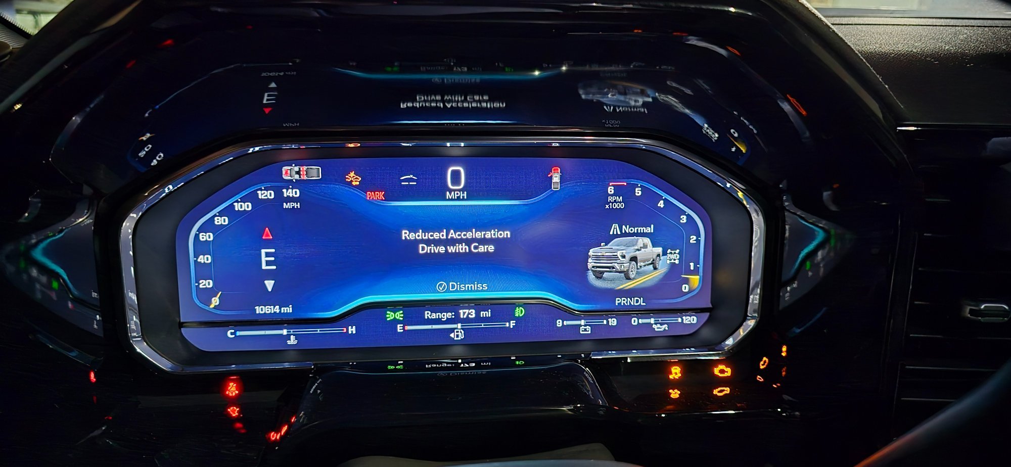

Update on the truck which currently has 10,614 miles. The engine was replaced and the truck had been driving fine up until the 10,000 mile mark. I noticed when coming to a stop the transmission would hard shift into first gear making it feel like you got rear ended at very slow speed. The truck would feel like it would push forward and then grab 1st gear. The transmission also at times hard shifts into gears when accelerating. Today I tried to turn on the truck with the remote and it would not turn on. When I got in the truck and physically turn it on , the dash read "Reduced acceleration. Drive with care" "service steering wheel column lock" "service esc" "service traction control". The truck was limited to 38mph and was stuck in what appeared to be second gear. I was able to limp it home and once I got home the truck had a noise coming from under the truck but I was not able to pinpoint if it was the transmission or the engine. It was not a ticking sound like the one it made when the engine blew. Tomorrow morning I will have the dealer send a flat bed to come and take the truck in for service. Needless to say ownership of this new ZR2 has been stressful due to its mechanical issues. I will attempt to upload pics of the messages on the dash and a video of the noise it's making now. -

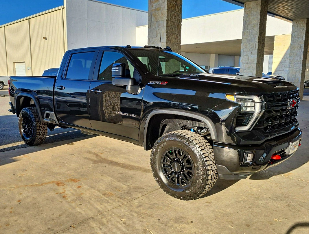

I bought my 2024 2500 ZR2 with the 6.6 gas and the first week of ownership at 193 miles it died on me while heading home from dinner. Left me stranded in a turning lane for 5 hours before a big enough flatbed arrived to take the truck home at 2am. Luckily I was already in my neighborhood and not on a busy road. The next day another flat bed took it to the dealership and they found that the whole fuse block on top of the battery was blown. They replaced it and the truck was working fine. Until yesterday afternoon at 830 miles the engine developed a loud knock that would rise with RPM. After noticing it I got on the phone with the dealership to let them know I was driving straight over there. Dealership put me at the front of the list for a loaner due to the circumstances and sent me on my way. Today I heard back from the dealership and they informed me that upon removing the oil pan the tech found chunks of metal. With further inspection they found a spun bearing on the crank. They sent the info to GM and they will be replacing the engine. As of now the turn around time is 2 weeks. Needless to say I am very disappointed with the experience I've had with the new truck. The truck itself is beautiful and rides so smooth with the ZR2 suspension. The Allison transmission shifts amazing. But seems like GM QC was not to par with my particular unit.
