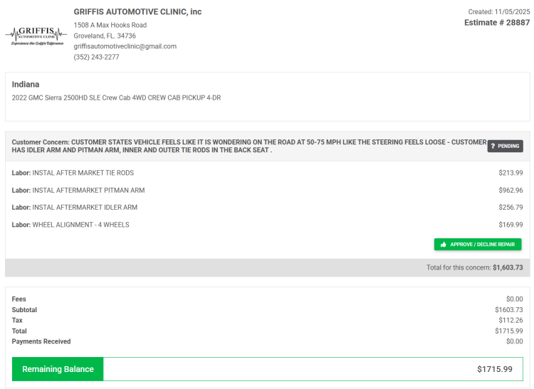

  17. My FIL said the same, all of that is a $600-800 job in my area. I think they raised there hourly rate to $400 an hour. Also they raised there alignment price $20 since April, they are a rip off now.

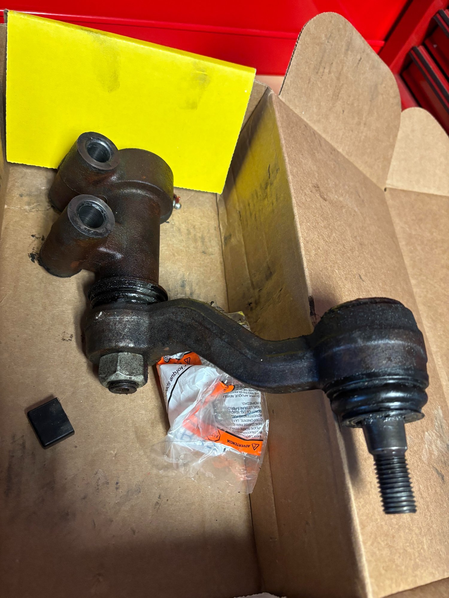

  20. Started noticing some wandering and drifting of the truck at highway speeds, kinda ever since I got the truck back in April of this year. Also the steering felt off and loose above 40. I installed a steering stabilizer kit in May as well, it helped a lot. But it got worse and like right turns felt tight and left turns felt looser. 2 Shops said it's 100%, no issues. I didn't believe it and swapped out the Idler arm and mount (it's all one assembly) myself in my driveway in about 20min. It's tight and doesn't wander anymore. Hardest part is getting all of the tools together. Also I got a quote from a shop for labor only to swap some parts, man these places are rip offs. DIY or nothing now. The old idler arm in the pic didn't have any play up or down that I can tell by hand, but it does rotate very easily, the new one you can barely move it at all. I installed the MOOG K400018, the new part is way better built, I would never use OEM GM parts as they are failing fast and 3-4x more. Huge difference. FYI, my truck is not lifted or leveled, running stock size Wildpeak AT4s so slightly heavier than stock tires. I tow 2 times a week and off road at least once a month.
