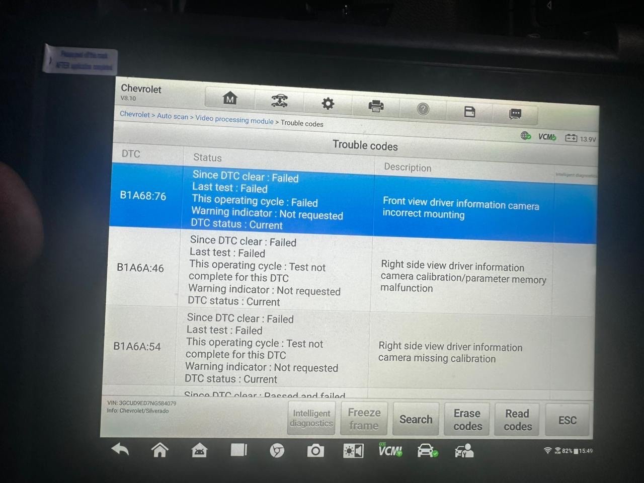

  1. Welp.. I’m back to square one. The lines have been gone for a while now and have been back n forth with the dealer for some time now. Anybody that had this issue and got a fix from a dealer themselves? Anybody info would be helpful. I even contacted whiteautoandmedia, they said the VPM is likely bad. But my dealer (I live on an island in the Caribbean, so my options are limited) is useless. I ran a diagnostic tool with a friend and this is what came up.
  2. Hey guys, I had the same problem with my 2022 refreshed silverado. what I did was pull the F11 fuse for about 2 minutes. That is the video processor module (VPM) and overhead camera. I then took a drive for about 10min during the day good weather. and voila the cameras synced and the lines are back. Hope this helps.
