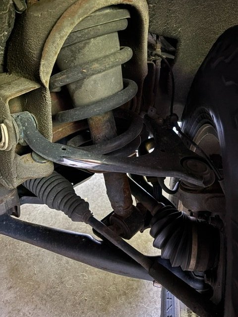

  1. Make sure you put your LCA's on the correct side of the truck. You can install them upside down and they will mount on the opposite side and look like they are correct besides the ball joint facing up instead of down. It's pretty apparent what is going on once you try to install the knuckle. Trust me I know from experience. Once I corrected that the passenger side bolted right up. I did have to compress the spring again and rotate it 180deg on the driver side. After that the tabs lined up. It sounds like the OP did the same thing I did so it can happen and hopefully this saves someone some time or at least some embarrassment in the future.

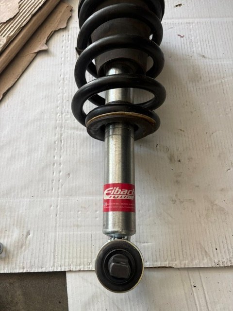

  2. Appreciate everyone's help and suggestions. I am going to man up on this one and admit my stupidity. I had the lower control arms on the wrong side and obviously upside down. I should have disassembled and then assembled 1 side at a time. Instead I disassembled both side ones night, cleaned up, and then reassembled the next night. It's amazing how closely everything still lines up with the arms on the wrong side. Close enough that I was able to get one side loosely bolted up. As soon as I went to put the knuckle on and saw that the hole for the lower ball joint to fit into was tapered the wrong direction it hit me what I had done. Once I swapped the LCA's the passenger side bolted right up imagine that. On the driver side I did have to compress the spring again and rotate it 180deg. Once I did that the angle of the shock and mounting ears all lined up as well. Have not got the new tires mounted and alignment yet (later this week), but the improvement was definitely noticeable over the worn OE shocks. I did end up getting rid of the 1/2" Rough Country strut spacer and then adjusted the Eibach's up all the way to the 2.5" setting. No rubbing on the Superlift UCA like I had with the OE one with the same tires. Did not need the wheel spacers.
  3. Thanks. Should have time this evening to work on it. I think rotating the driver side shock inside the spring 180deg should put that tab angle in good alignment. On passenger side doesn’t seem like the tabs have much of an angle on it either way. Seems like I might need to rotate the tab on that one a bit. To clarify are you saying that compressing spring and releasing tension will allow the tab to rotate easier as well ?
  4. Hoping to hear the resolution on this. I am having the same issue. I am not 6' 7 but I used all the leverage I could find and could also not rotate the mounting ears in that bushing at all. Pictures below are of the passenger side which is closer to aligned. I think I can probably figure out a way to get these bolts started maybe attached the shock bolts first then jacking up the LCA and man handling it in place. On the driver side though its farther off. Maybe 10-12deg. I asked this same question over on a thread I had started earlier about the parts I was compiling for the front end rebuild. I found this thread after I posted the same question there. suspension-component-replacement-125k-miles
  5. Trying to wrap up this suspension install and ran into a problem. I have researched it and do not see other people having the issue so assuming its something simple I am just missing. The ears on the front shocks do not line up with the holes on the lower control arm. They just need to be turned maybe 15 deg or so. I assumed all along this would be a simple tweak with a long wrench and they would turn and I could line them up. I cannot for the life of me get these to turn. I have put a ton of leverage and pressure on them they won't budge. Assuming I am doing something wrong and don't want to break anything. Googling it AI says everything from Yes the ears can be rotated with significant leverage and force all the way to the shocks are side specific, or you need to rotate the shock in the spring. I just risked life and limb to compress those spring to get these lifted shocks in so I am really hoping I do not need to do that again. Can someone tell me if these ears can be rotated if so how. If not then what do I have assembled incorrectly that would allow these ears to line up. Trying to get this finished ASAP so I can get the tool rental return. Thanks!
