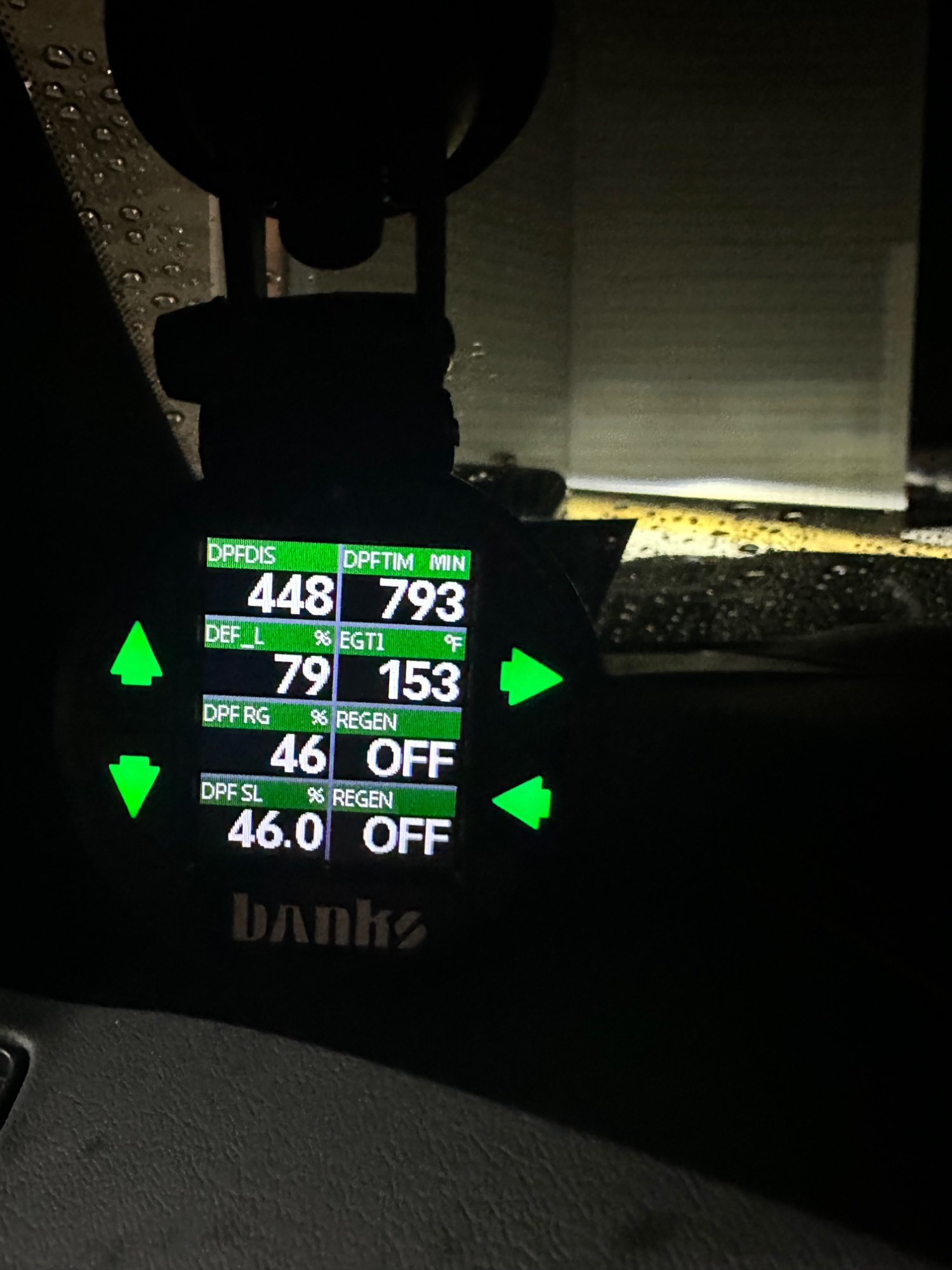

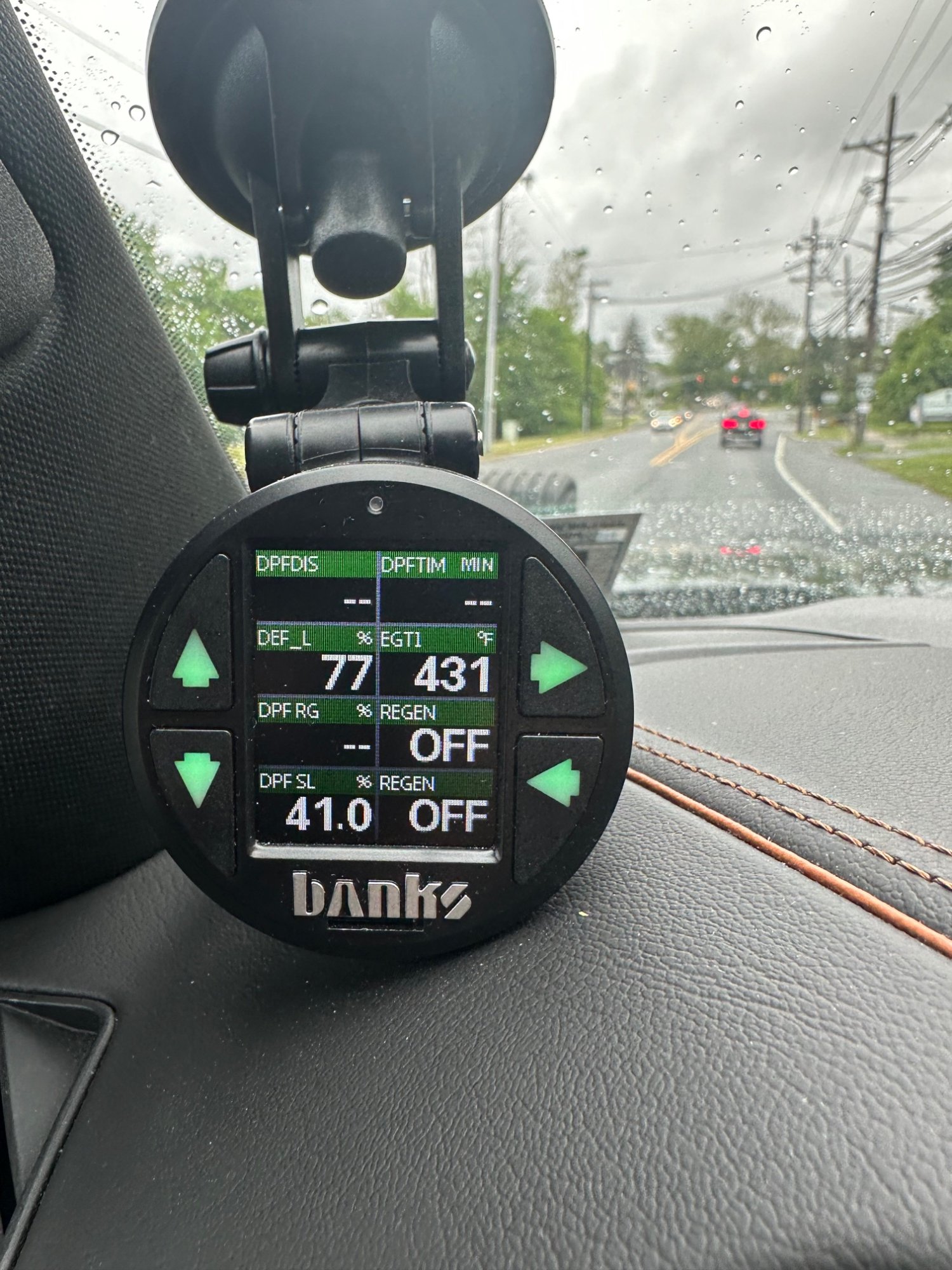

  4. I have a 2022 GMC Sierra AT4 with the 3.0 LM2 and an idash. Does anyone have an issue where the DPF RG % (which I believe is DPF Regen Trigger in the gauge selection menu) is blank. This also impacts the DPFDIS and DPFTIM which I assume is calculated off the same data. When I first start the truck all the above parameters display correctly but in under 60 sec they all go blank (actually display ‘—‘). If I unplug the iDash and plug it back into the OBB port they display again and they disappear. What really strange is that a couple times I did this and they remained on for my entire 60 min trip. This was happening with iDash 1.24 firmware. I called Banks and they sent me firmware version 1.24.7 but nothing changed. For some reason the DPF Soot Level % does display. Does anyone else have this issue? I did have some other iDash related questions: 1. Are the DPF soot level % and DPF RG % the same parameter? and the only difference is one has a decimal place that never displays to that accuracy? They seem to be the same but it confuses me why one displays constantly and the other displays ‘- -‘ after 60 seconds or so. 2. Is there no parameter for oil pressure? I know there’s a gauge on the trucks dash that only has values for 0 and 120. My oil pressure sits at about 25% on the gauge (~30psi) at idle which I guess is normal from what other posted. 3. Is it normal for the soot level to rise at different rates between regens? For example I drive about 30 miles to work. A regen kicked in about 5 miles in. Probably took 11-12 minutes The regen stopped and the soot level read 16%. Then it displayed 0%. By the time I got to my work it read 26%. I didn’t track the miles after the regen but it couldn’t have been more than 20 miles. Drove another 30 miles home and the soot level read 46%. At this rate the regen would take place at 100-120 miles. However my regens typically happen in the 375-450 mile range. The DPFDIS (distance between regens) currently reads 448 miles. Is the sensor or iDash just that inaccurate or is it some type of scaling issue. I feel like it raises really fast right after a regen and as it get’s closer to 100% it raises slower. Just curious if anyone else experienced this and if this is just normal. The truck is running fine and haven’t had any issues.
