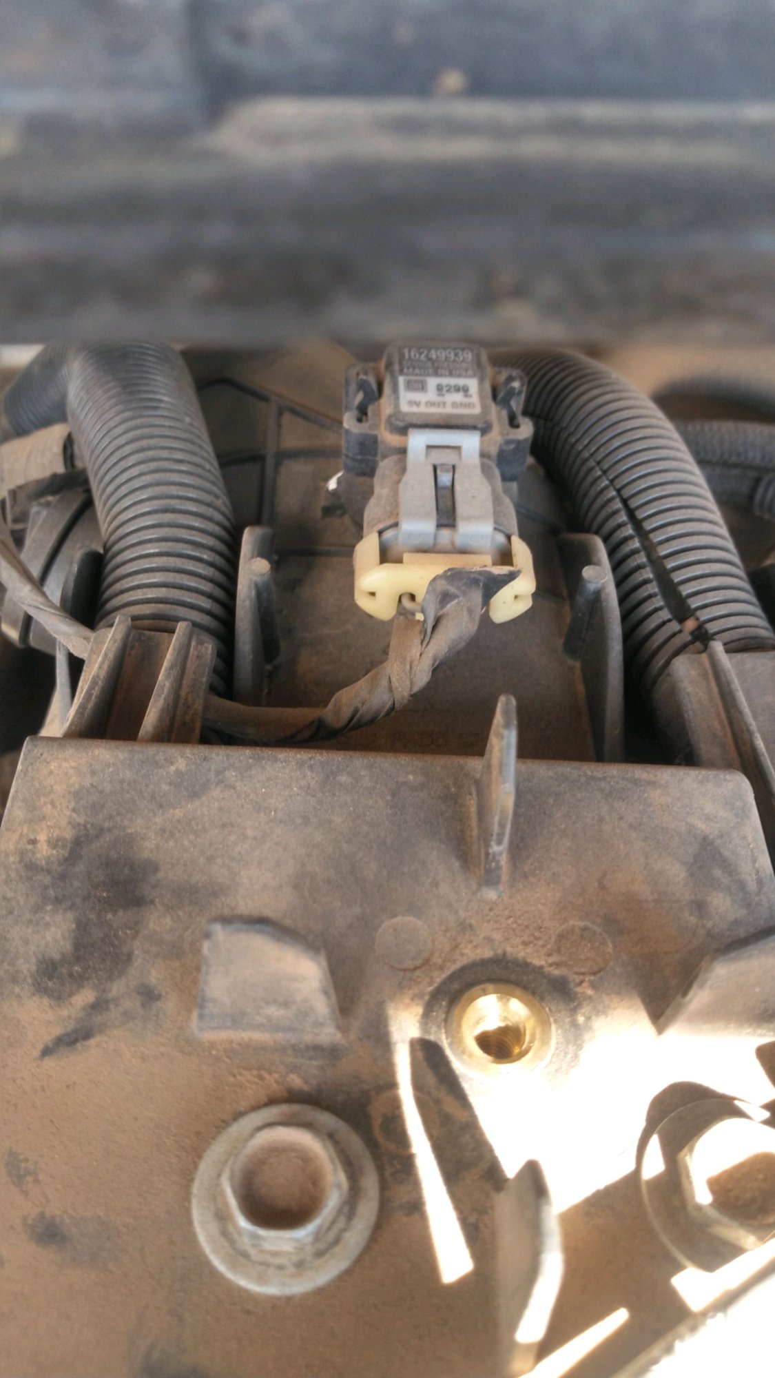

I have a 2000 GMC 4x4 1500 3 door ,has 157,000 + miles, always taken care of and put on new parts when needed was wondering if anyone can tell me what these 3 items are and their functions on the 5.3L engine. These are one top the engine with cover removed, I know the TPS and the MAF sensors and the Pressure regulator but was wondering abut these , see the 2 pictures. One looks like a solenoid above the TPS and the one behind it to the left on the plenum? the 3rd one is under the firewall cowl at top rear of engine. Ron

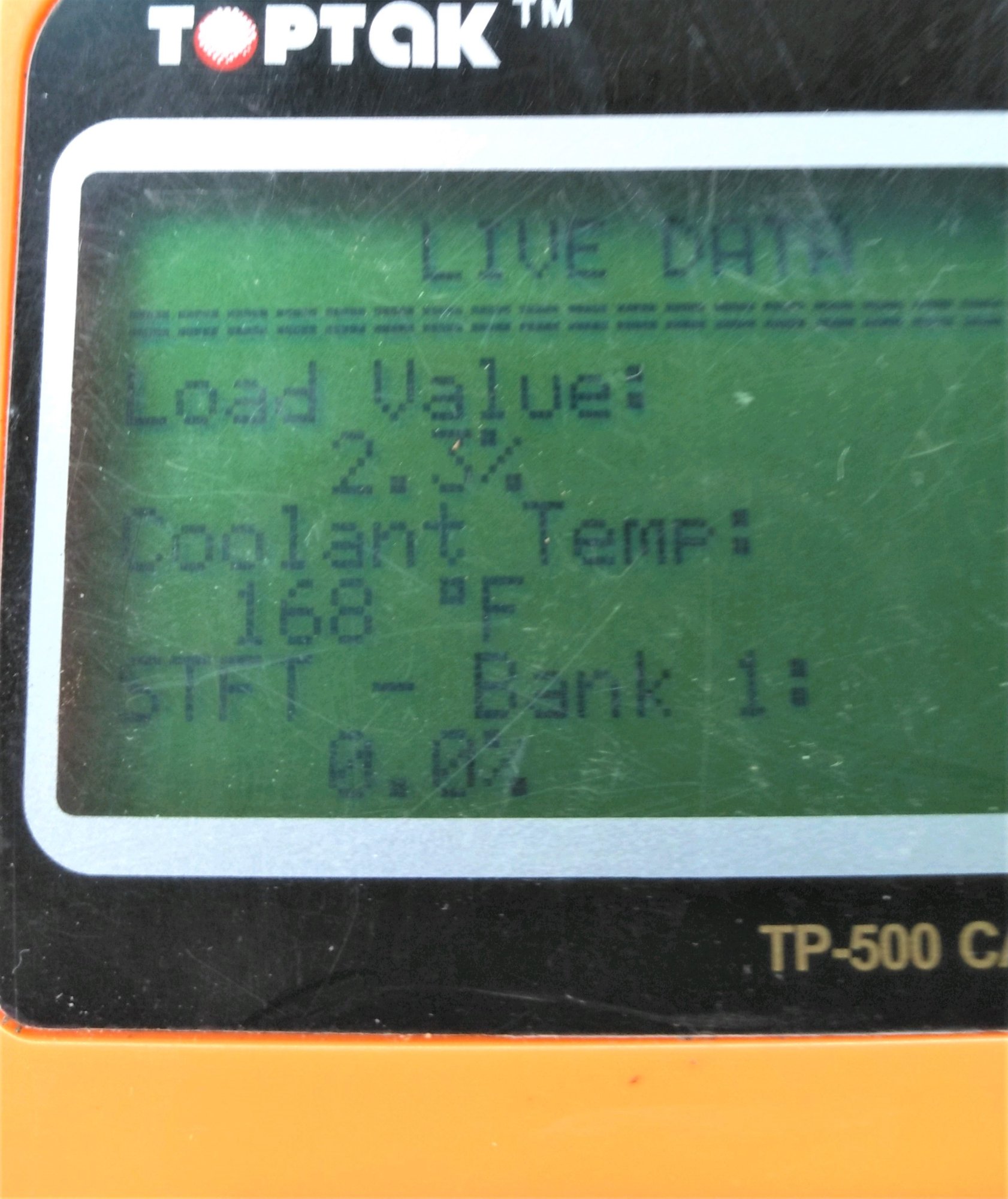

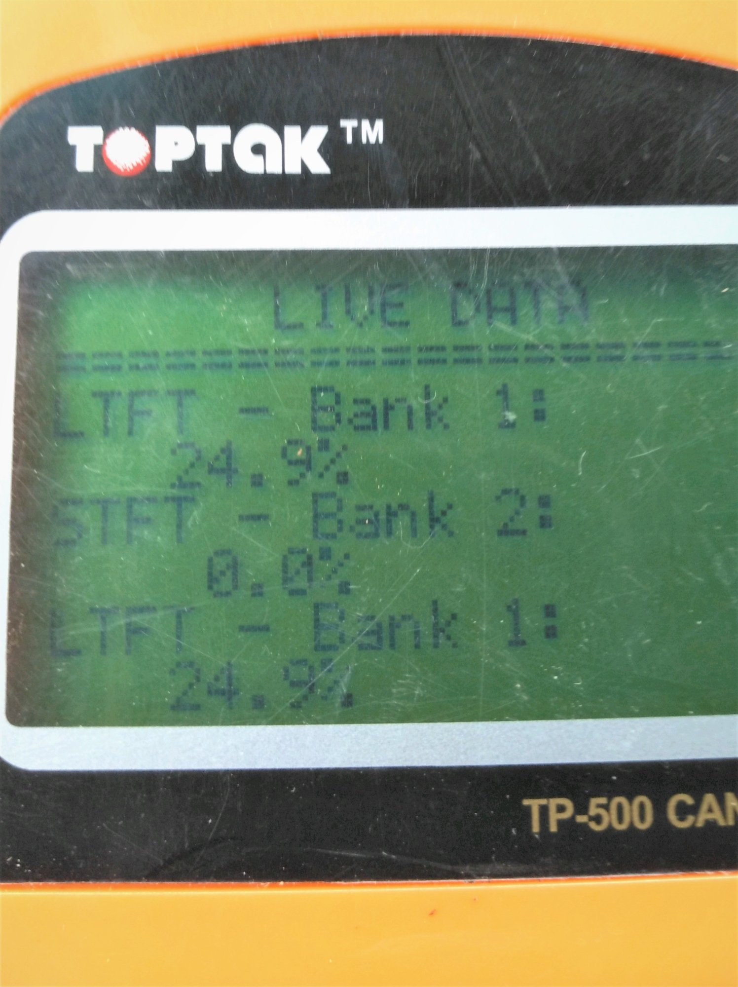

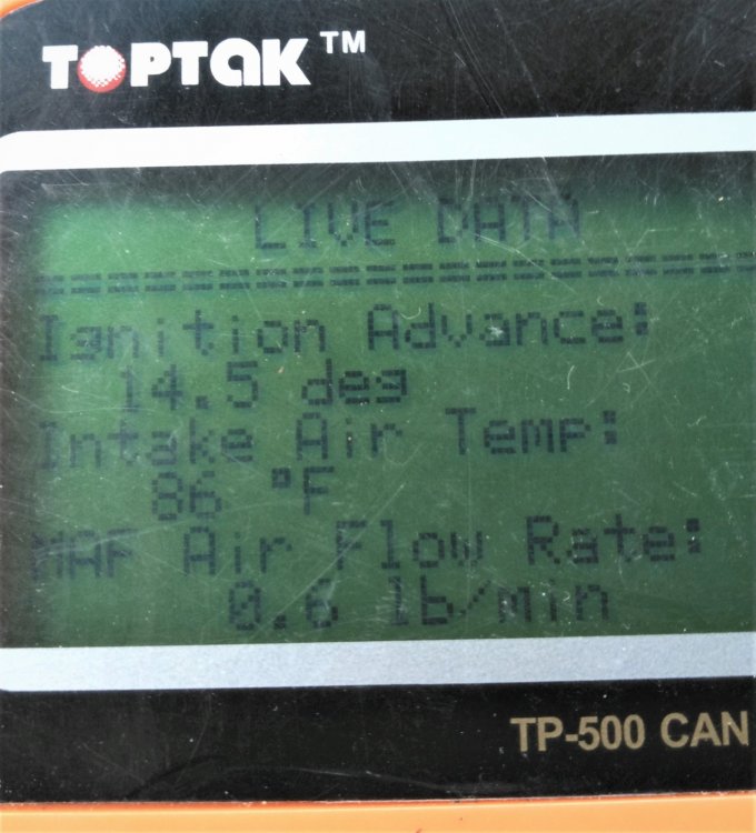

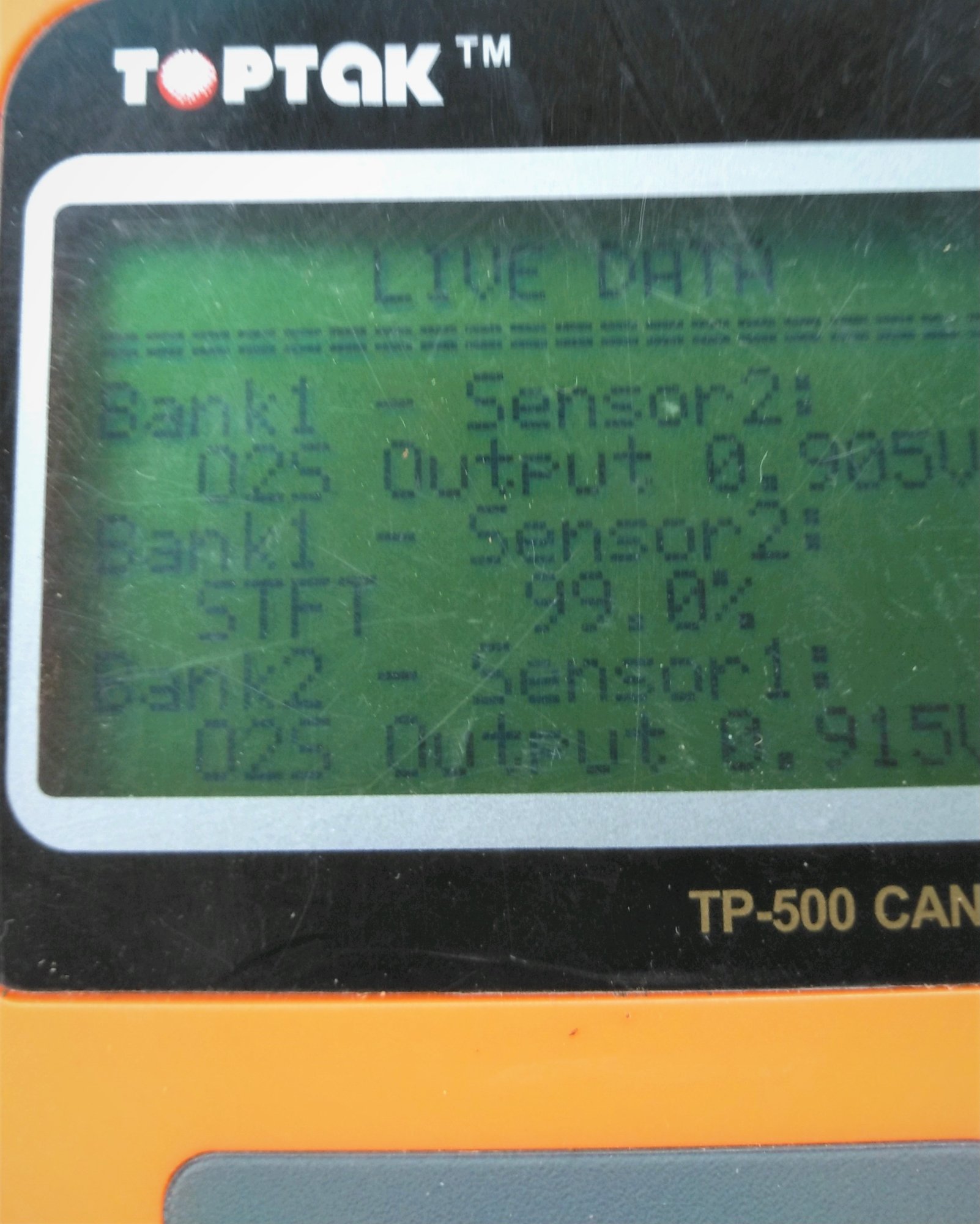

I have a 2000 GMC 3 door Sierra Automatic loaded with 170,000 miles, well maintained with records kept. Its been stalling lately and surging enough to be scary in traffic. Also when I start it cold of the morning , I stand beside it and reach in to start and it has been idling low to the point of dying at least once, starts ups are good though and I always allow it to come to temp before driving. Past few days I got in the seat and turned on ignition and stepped on the accelerator before starting to give sensors a voltage value, it didn’t help. Today I changed the fuel Filter and it needed it but I have seen worse, I placed my old scan tool on it and took some screen sots of it while idling, the only code was PO171 that said it was Too lean. I looked for air leaks on the vacuum hoses and purge vale and all along the air intake boots for the MAF sensor to the valve plate , I see no cracks or breaks , nothing. Is there anyone that can look at these screen shots of my scanner and give me a good guess or where to look and how to find my problem? Only major repair on engine was done by me about 6 years ago and I changed the Knock sensors because of detonation and I used OEM sensors and Felpro gaskets, I was a Mechanic for about 25 years in the 80s-90s. Any help would be appreciated
