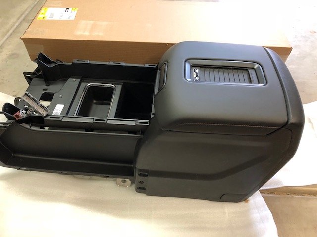

  13. Just about 350 miles on my 2018 crew cab Silvy, and the console parts arrived this afternoon. Now I’ve got to read back through this thread for details on the necessary hardware/bolts I’ll need to source locally; plan on making the swap this weekend. Also plan to follow up with pgamboa about his plug/play wire harness.
