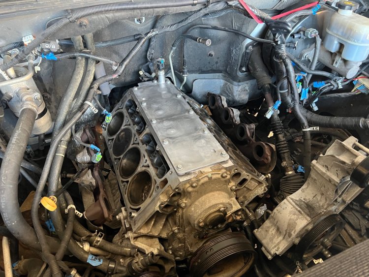

  5. Cam, lifters in, and valley cover changed. Worst part was getting the VVT Cam phaser lined up with the timing marks on the crank, because I couldnt' see them with the oil pump being there, and I couldn't pull the oil pump without dropping the oil pan, and so on. So before I pulled the cam, I set cyl1 to TDC (and cyl6) as well - easy to verify without heads. Timing mark on the cam phaser was at 6 oclock. Removed phaser, then cam. Did not adjust crank, again verified easily with the pistons. Installed cam in block, phaser on, mark showed off one tooth. Adjusted one and it points down to 6 PM again. Buttoned back up and hopefully I got it right. Heads go back on next with manifolds and radiator and then will fire her up.

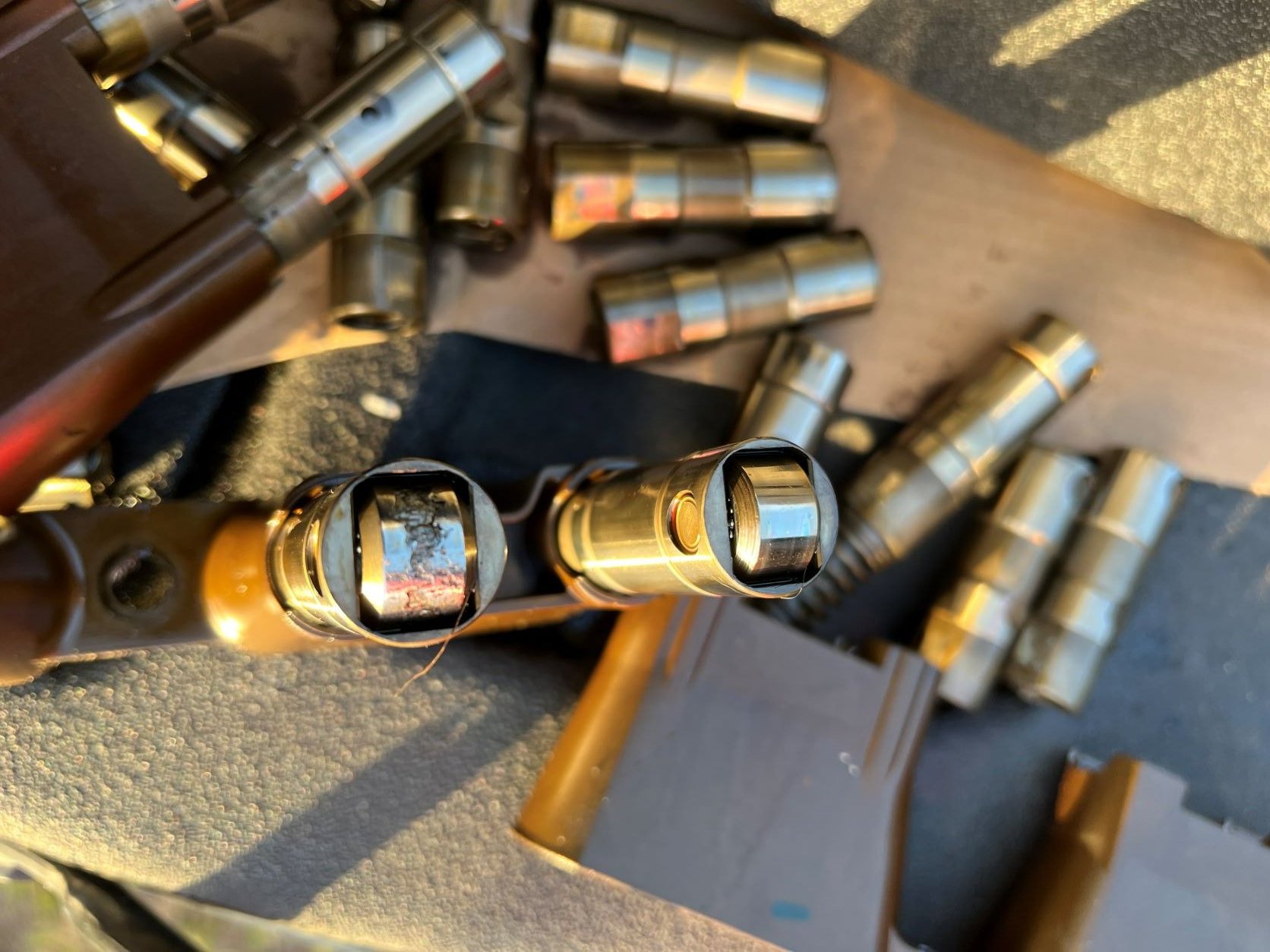

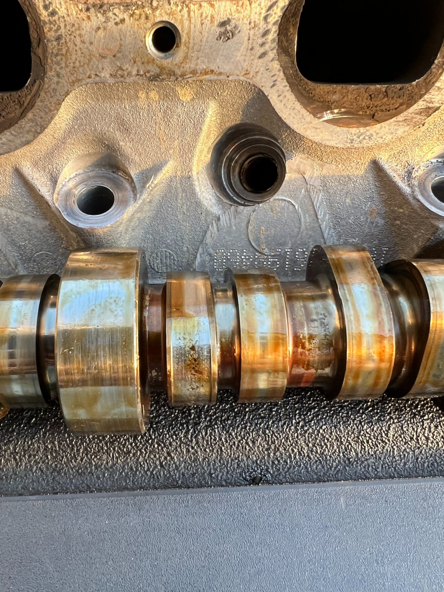

  8. Torn down. Easy to see where the #6 lifter was chewing on the cam a bit. Looks good internally. Hope it goes back together no problem.
  9. Got all the exhaust bolts out easy, no PB needed. Didn't break a one. It's torn all the way to the heads at this point, been a piece-of-cake and hope it continues to be. No sludge and valvetrain looks new, all pushrods and rockers very good shape. Haven't seen the cam yet.
