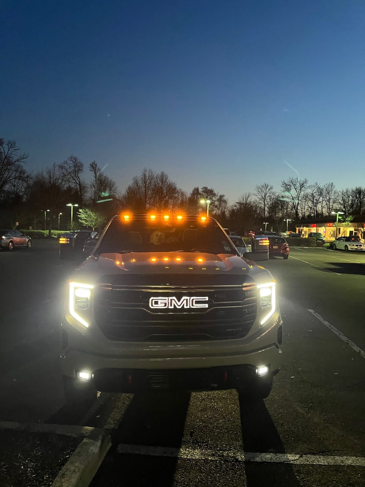

  1. so just an update I successfully installed the OEM gm tow mirrors on my 2022 sierra at4x with the boost auto RZY harness and the OEM gm door harness. The only issues I have to get fixed is the camera angles when white auto media can update the VPM and the mirrors kind of don't fold in and out properly I have to hit the button a few times sometimes to get them to fold in or out. Any insight on the folding mirror part would be great. But overall worth it and love the look
  2. hi i know it has been a while but just an update here from my 2022 AT4X DQS add. I successfully installed the tow mirrors and now the door harnesses (took a while to get the door harnesses from gm). The power fold works along with the heat, power adjust, work lights The camera angles are off i have to wait until wmas can adjust them not a big deal hopefully soon. But the clearance lamps, turn signals, and back up illumination lamps do not work. I assumed the turn signal would work because i had them on my factory mirrors but they don't any ideas why ? I am going to try giving boost auto parts a call today see if they can help me out at all.

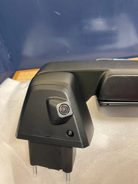

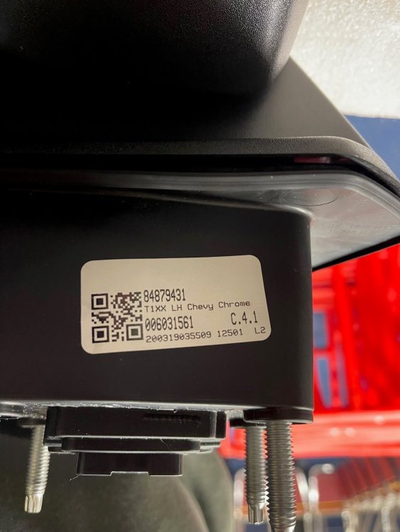

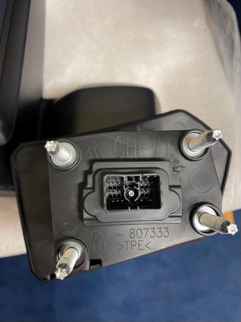

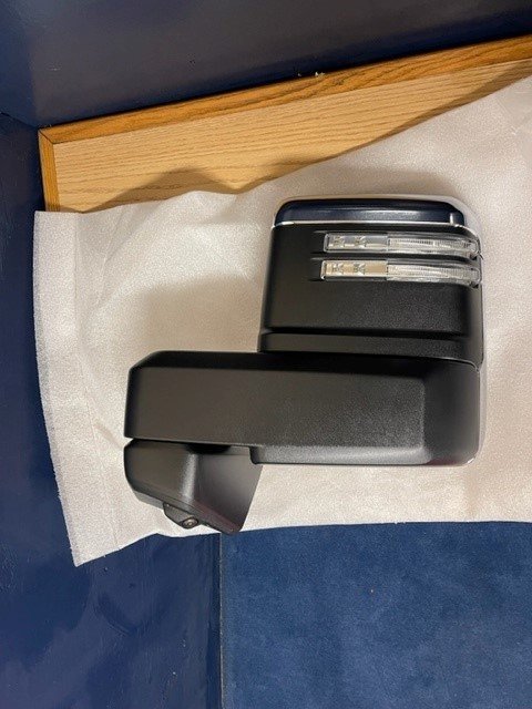

  4. Brand new in the box only opened to take pictures. I ordered this before realizing that the sierra and Silverado door stamps are different. These mirrors are fully loaded for the 1500s they have the 360 cameras and are heated, power folding, Blind spot monitoring, signal on the front. My loss your gain looking for $600 plus shipping but i am willing to work with you on shipping. This is for the drivers side new in box you would need to get the passenger side. Located in New Jersey 07747

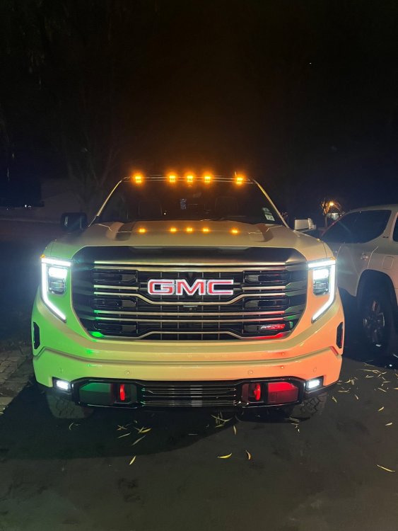

  5. So i wound up grabbing a pair before NEWDUDE responded to me and i thought i would just throw them on to see fitment. Power fold and power adjusting mirrors work like factory. The task light activates the running lights, the puddle lamp activates the task lamp now, and the turn signal and rear illumination lights don't work, and camera angles are different like the guy who posted it on the previous model. I assumes i could get the required door harnesses or repin the door harness around to get the features to work correctly but ill wait for newdude to proceed at this point. On another note i have a brand new drivers side Silverado tow mirror in the box 84879431 if anyone is interested shoot me a PM. ue

  10. hey man i am looking to do the DQS swap myself and the dumb*** i am ordered the wrong mirror for the drivers side. i ordered 84879431 which is the Chevy Silverado with all the bells and whistles when i need the GMC Sierra one. Shoot me a PM if your still interested deff a great deal. i can send you pictures/video/FaceTime the part before i ship it too.
