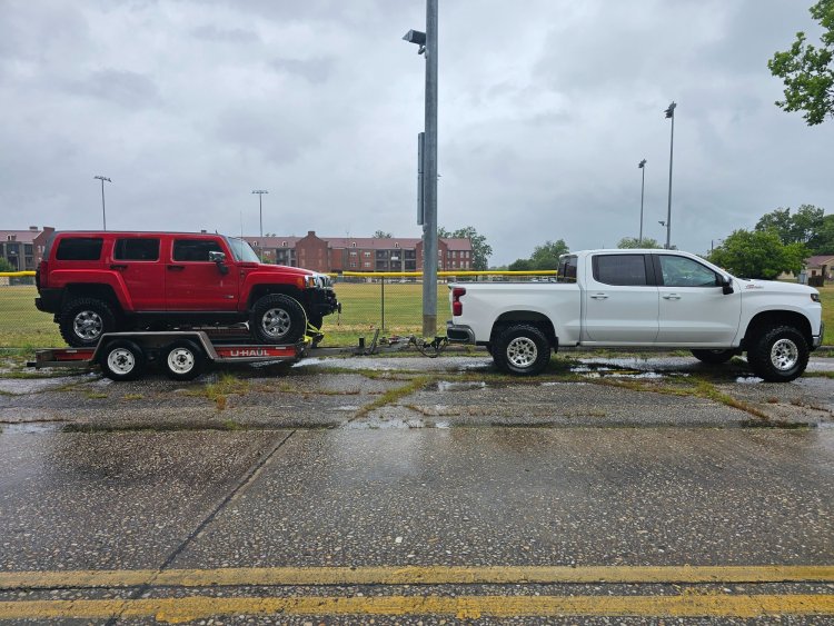

  12. Hey guys I need some input on the subject. I have a 2020 Chevy Silverado 1500 lm2 z71 crew cab, 4" lift, air bags, Bilstein 5100 rear shocks, and 34" tires with a door rating of 9300lbs towing capacity. I've towed over a 1000 miles hooked up to a hummer h3 with 35's, winch bumper, and back seat drawer on a uhaul trailer before with ease from NC to TX in my truck. However I am looking to buy a 34' Travel Trailer with the following weight ratings. "WILDWOOD 28VIEW TRAVEL TRAILER" Dry Weight 7,753 lbs. Payload Capacity 3,512 lbs. GVWR 11,265 lbs. Hitch Weight 1,065 lbs. I never intended on towing it with the tanks full. I will be living out of it and will only be towed for moving from one camp to another, not frequent use. Should I still be safe as long as I don't exceed ~1800lbs in the trailer cargo? I will also have a "Weigh Safe True Tow Middleweight Anti Sway Weight Distribution Hitch 6" Drop 2" Shank 12,500 lb Tow Rating" Thank you!
