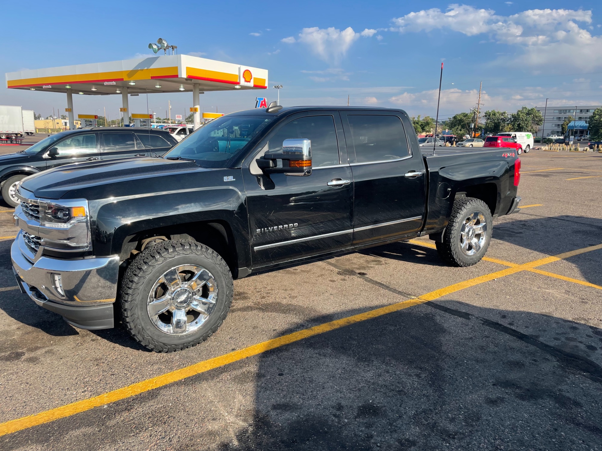

  3. Haha good call, I was driving it home from the CB shop and had to stop at Oreilly’s sonic was quick in and out I love this new setup though, adding the tuner and cold air intake next. All about the trucks here for me rather than the hoods

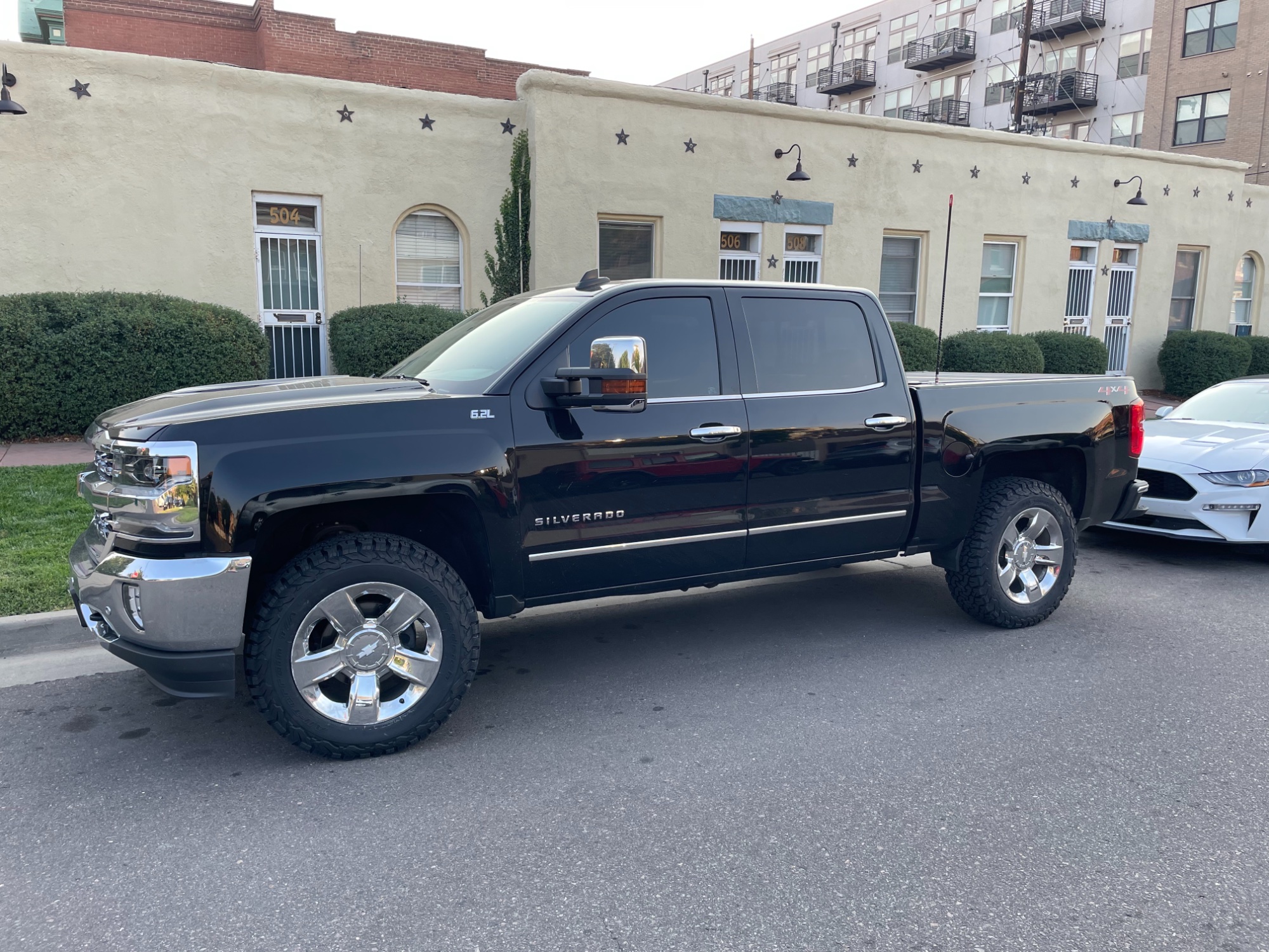

  4. Bilstein 5100’s front and rear with the front on the highest setting and a 1 inch block in back with 275/65/20 load range E for towing my travel trailer KO2’s. It took me forever to decide on what setup to go with and couldn’t be happier with this. Comments or questions welcome!
