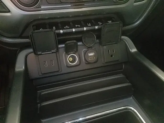

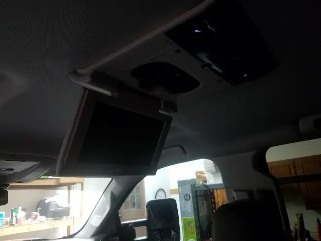

  1. I have finally got around to finalizing the install of the OEM RSE system for my 2016 Silverado HD. This was the only option that I wanted that my pickup did not come with so I am extremely happy this is done and so is my son! I would like to give a BIG THANKS to Anthony and John at MVI (www.gm-navigation.com) as they are extremely knowledgeable and their customer service is top notch. I purchased MVI's in-dash Blu-ray and RSE kits along with the unlocked HMI module and added their HDMI input and third brake lamp camera with switch. The unlocked HMI is definitely worth the money over a Lockpick as you have full control while in motion and don’t have to worry about the Lockpick failing as I had 2 of 2 fail in my old 2010 Silverado. MVI supplied most of the parts though I did source a few parts from the dealer as I did vary a little from MVI's kit as I wanted the RSE controls in the center console which their current kit does not yet have but was told it is on their to-do list with many other projects. Their HDMI kit requires the RSE controls as you tap into those inputs. I removed one of the cigar lighter outlets in the front of the center console and mounted the HDMI input there. If you stick to their kit, the install is fairly simple IF you have a sunroof. Once again, MVI offers great customer service in case you do run into any glitches. They are also a vendor on here as well if you did not know. NOTE: ***NON-SUNROOF VEHICLES*** You do need a new headliner if you don't have a sunroof as you need the mounting bracket for the screen which offsets the screen from of the original position of the overhead dome lamp leaving ts existing hole exposed. On sunroof vehicles, the dome lamp and screen use the sunroof frame to mount to and you just enlarge the existing dome lamp hole.
