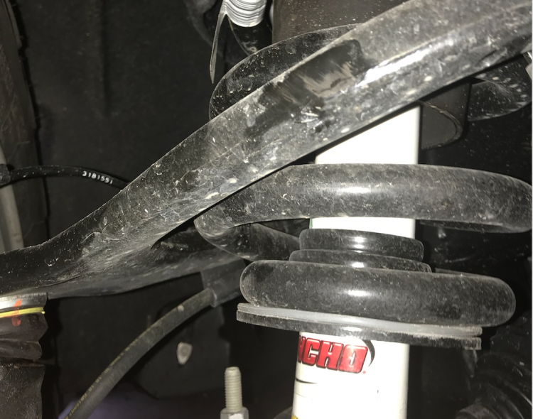

  1. Only rubs UCA on passenger side on full left turn. Had to zip tie the fender liners back as well.
  2. If we are talking about rubbing the plastic, you hear a noise inside the truck but its harmless and easily fixed. if we are taking about rubbing components, thats a different story. IMO if you did it quite often it would probably be harmful but its probably not as bad as rubbing a concrete curb with your sidewall. Its something I can live with until I get a new set of rims in the future.

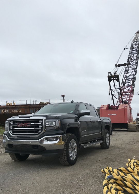

  3. 2018 GMC Sierra SLT 4x4 Z71 2.25" Procomp front only level kit - Dealer installed 275/65 R20 (34.1" x 10.8") BFG KO2 tires on stock 20" chrome wheels Very minor rub on passenger side inner fender well, fixed with zip-tie. Rubs passenger side upper control arm at FULL LOCK turn to the left; you really have to be turning hard to make that happen. Driver-side seems fine, I can't make it rub at all.
