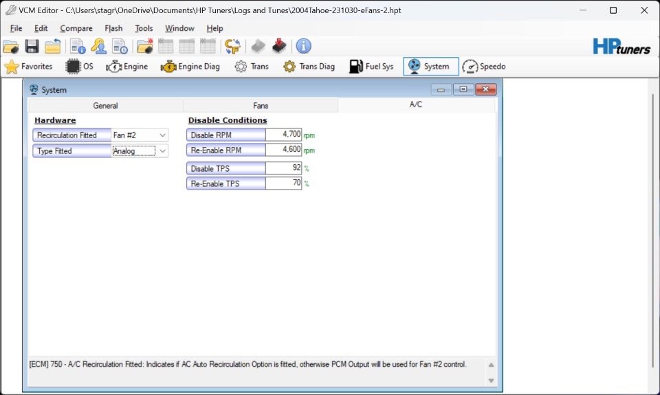

  2. So apparently I screwed up the AC configuration when I added electric fans to my truck. Playing around with Hardware settings in this screen and these settings allow the compressor to turn on and the FAN #2 to turn on in my 2004 flex fuel Tahoe. Why these are right (or are they??) I have no idea…. Hack hack hack. The recirculation actuator was a separate issue. Had to replace my dash controller and the actuator to get that fixed but it still didn’t get the clutch to turn on…
