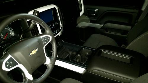

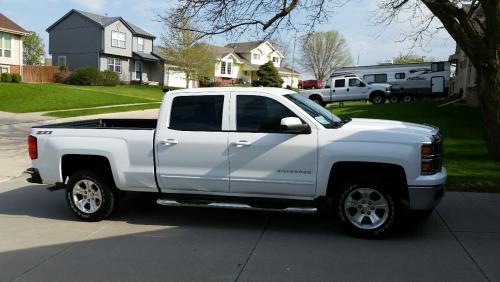

  2. Here is my 2015 1500. Just got it 16 April! Spent quite a bit already! Installed larger Center console too! PlastiDipped interior trim and emblems on side and front and back! Check out the rest of the pics on my link below!

  5. Installed the floor console in my 2015 1500. Check out the pics on my link below. I also put a parts list on there also for guys needing Black Interior with Greyish Trim on Radio which is called Synthesis on the parts list. The step by step directions that darkfox1 posted were great except I did not have to cut the wiring harness out of the jump seat. I was able to disassemble the jump seat cargo box and get it out. Also, the bolts that secure the seats to the floor are T50 and a T50 socket is incredibly handy to have when doing this! Thanks to everyone who has posted on this subject. It really made it easier to do this!
