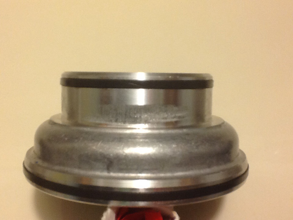

  2. Found these marks on the piston,definitely not normal wear Only 80,000 on the trany

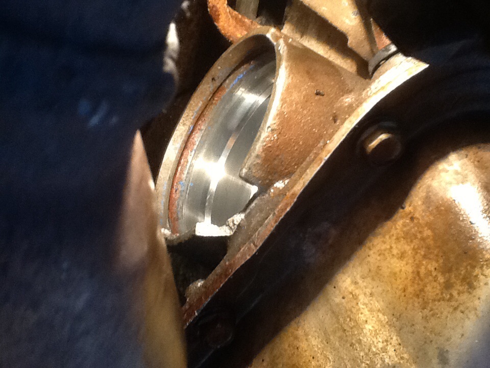

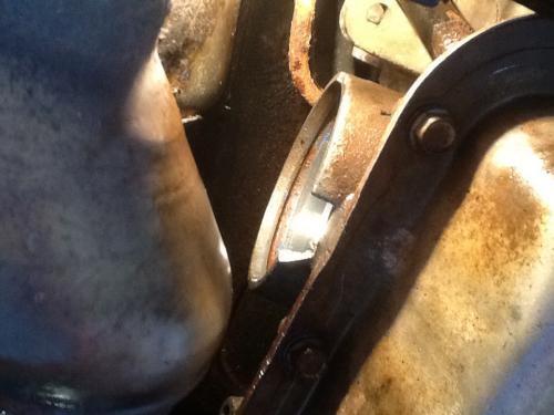

  3. 2003 Silverado 4x4 4.3 V6 After hours and hours of research this job DID NOT go as easy as I was led to believe First off the cover snap ring was fused by rust to the case.By the time I got it off the snap ring looked like wet spaghetti .Junk.Broke a piece off the case to Okay now that the snap ring is off,nope the cover would not budge,hours later I give up.So I put the snap ring back in as best I can and kinda hope that it holds.Well what I couldn't do in hours the trany blows out the servo in minutes of driving leaving me on the side of the road.In a weird way I'm finally glad it's apart at least. So I get the truck home and find out that I have to take the servo totally apart while in the transmission.That was another surprise.So now I know it's gonna be a pain in the ass to assemble the servo piece by piece. Be prepared for quite the job if you live in the rust belt. I'm now waiting on a new snap ring as it didn't come with the servo kit
