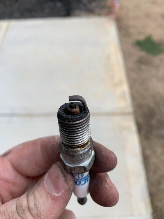

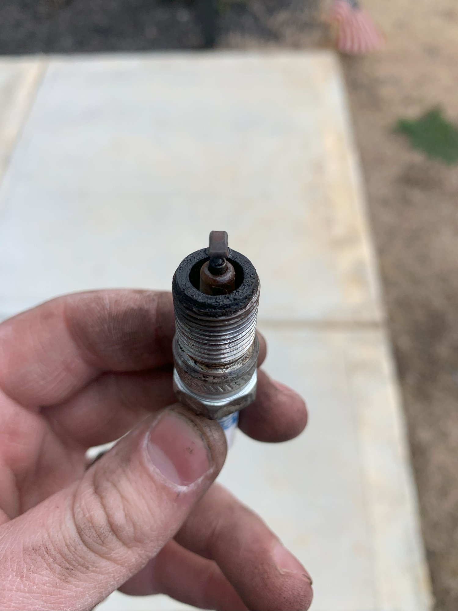

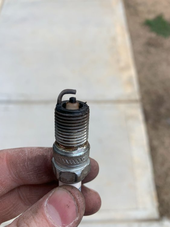

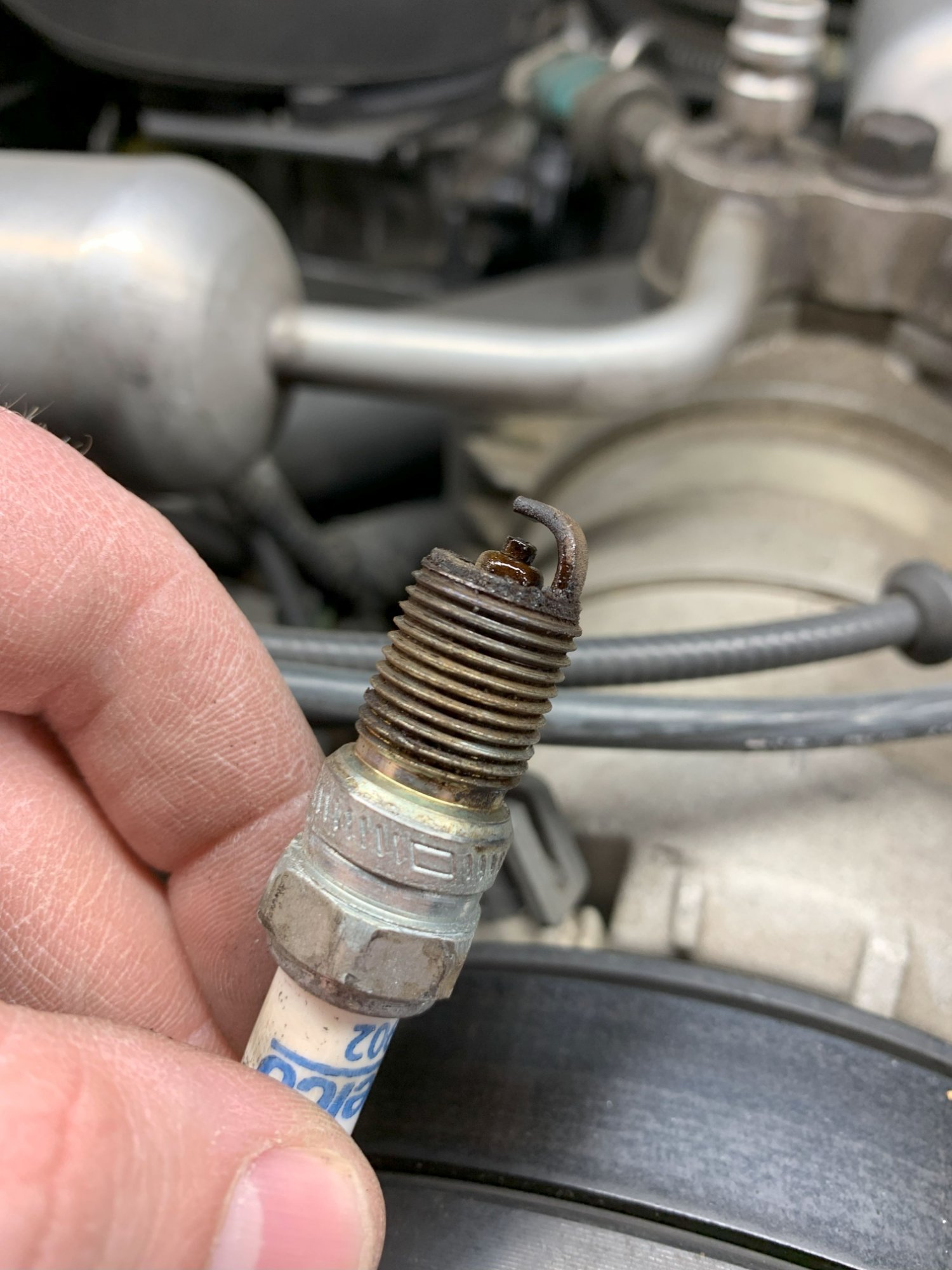

  4. Another update that could be relevant: I changed the spark plugs on my truck. The 4 plugs closest to the rear on both sides have oil on the ends. Not a ton, but its enough to immediately notice and be concerned. My truck tends to "use" oil between changes, and I change the oil every 3500 to 4000 miles. My truck does have the oil filter adapter kit installed. I replaced all 8 plugs. I didn't do the wires or anything else as I was short on time over the weekend. I have noticed some improvement in the smoothness of the engine. I still believe the O2 sensor change helped the most so far for my truck. I found a reputable shop in the area I am in now and I am planning to have them check it. They have confirmed they have more advanced tools and skilled techs that can do a deeper inspection and diagnosis.

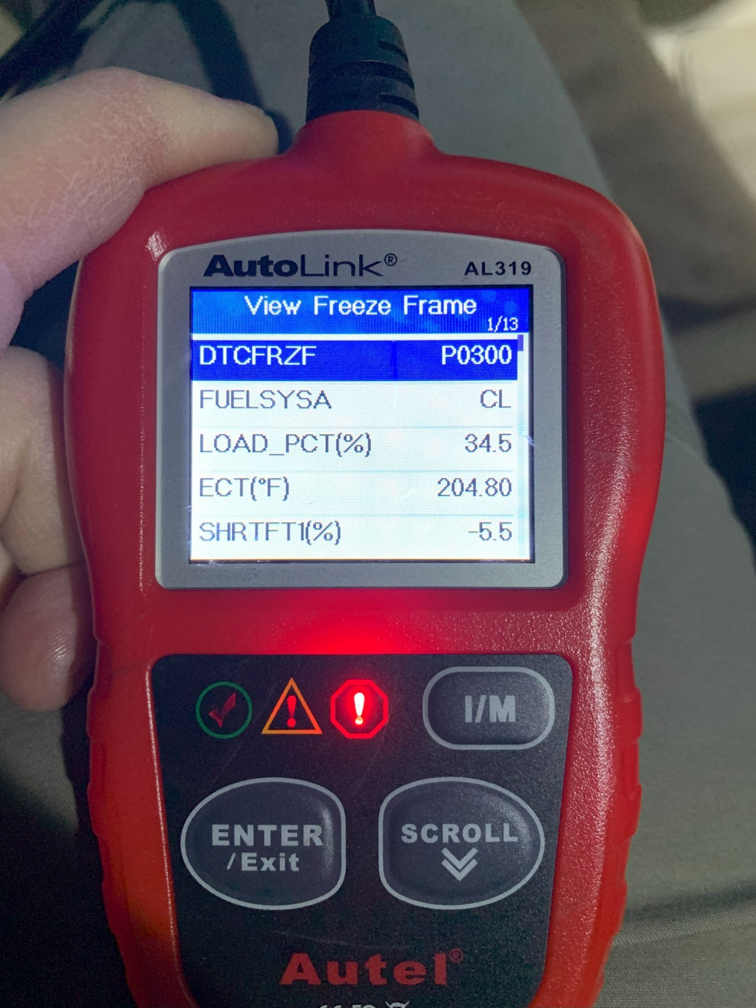

  19. So I ran some engine cleaner through it earlier today, and then took it for a good 25-30 minute drive. The drive ended with a test on the steep incline road near my house with more throttle. Got the P0300 again.
  20. I was doing an oil change recently and pulled the spark plug from #3 to inspect. This is how it looked at time of removal. I also checked plug #1, and it looked similar to #3. I am planning to replace the plugs soon.
  21. At the moment I have a basic Autel AL319. I am planning on getting a better DIY scanner like the Autel AL539B or AL629
