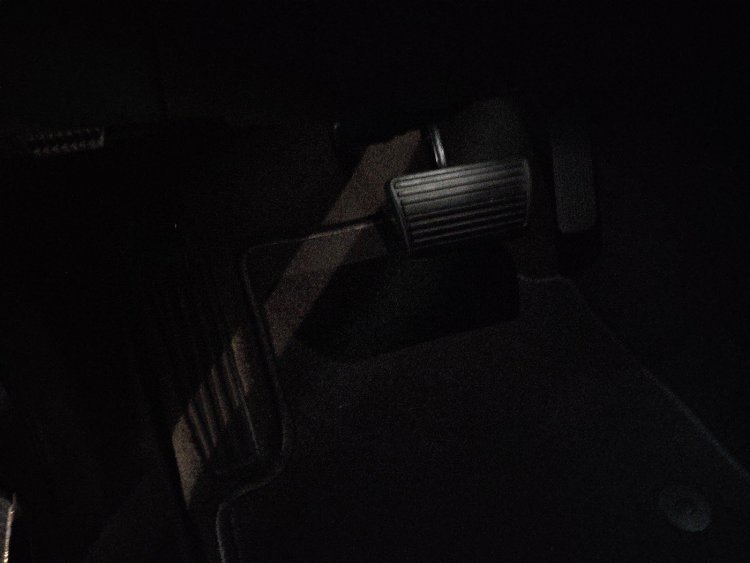

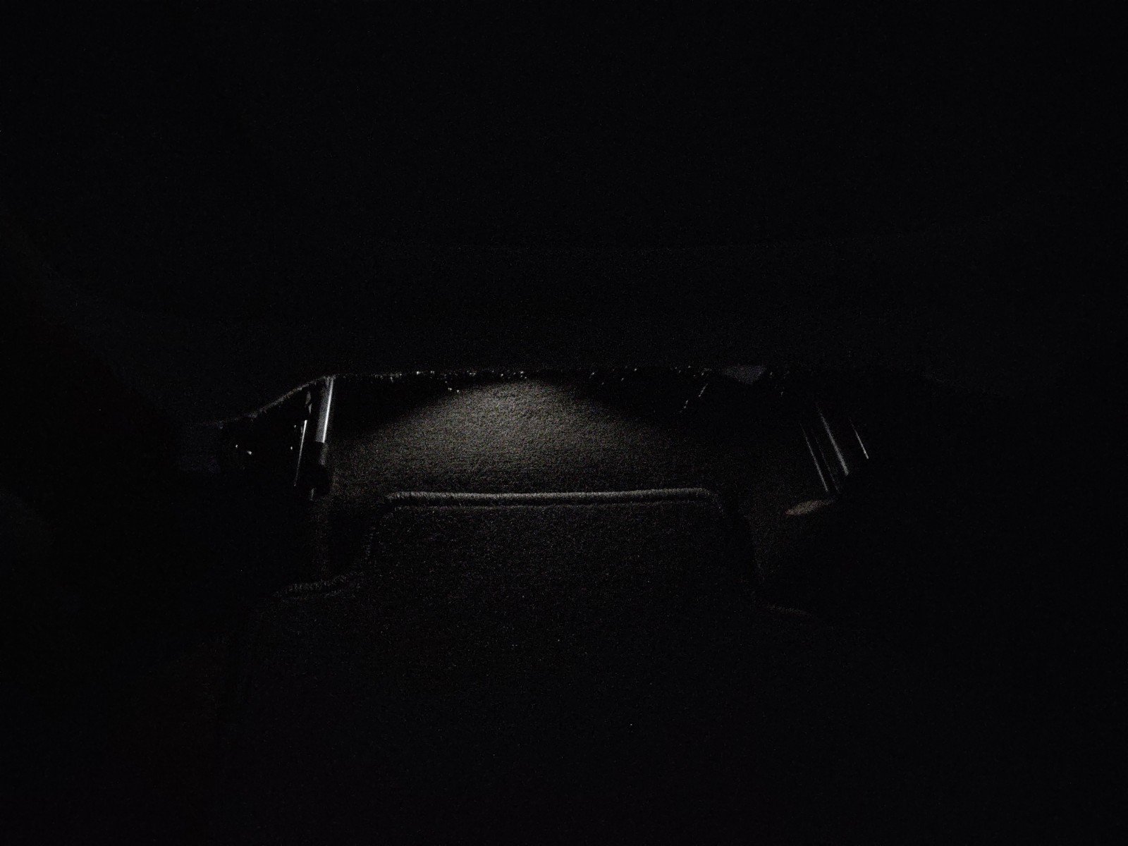

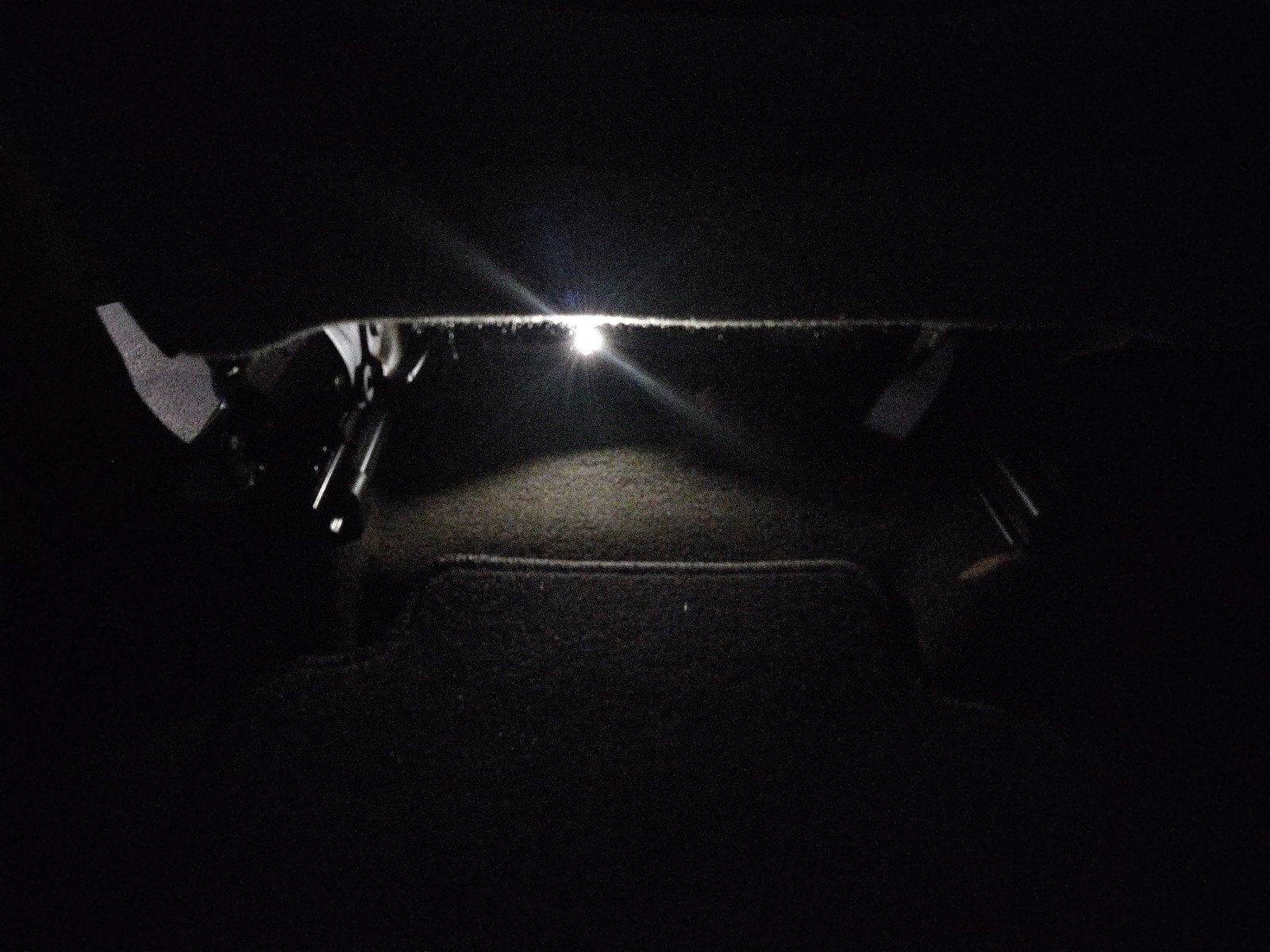

  2. It really wasn't hard at all, I had it done in about 2 hours,. minus the prep time of getting the leads ready, that was a couple hours... I bought (4) OEM GM leads off of eBay. P/N 12085535, or you could get them from @pgamboa Harness Dr.. I rough measured from the mounting location to about the gas pedal area, cut some 18 gauge wire (red/black), and heat shrink butt connected them to the GM leads then wrapped each one up good in harness tape.. I mounted all the lights (there are factory mounts in the trucks, except for the passenger seat, it's not a power seat) , I then ran both back seat light wires under the seat rails and up along the inside edge of the console. I took both passenger and driver's side light leads and ran them up to the front of the console up by the console mounting bracket.. I cut back all the black leads and terminated them with a 10mm electrical connector and mounted the negative to a dash mounting bolt that had enough bolt threads to get the terminal, lock washer and a nut on.. I then cut all the positive leads back and connected them all together. I took a piece of wire long enough to reach from the BCM to under the console. Butt connected all 4 leads to the single lead and wrapped that up good with harness tape. I used a T-tap on the violet/green wire in the video and ran the line to that...

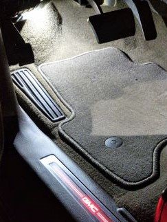

  3. Latest Mod.. Added OE Yukon/Escalade ambient floor lighting.. These lights stay on while driving and are the same light as the roof console center light.. I followed the install process here.... 2015 Silverado OEM Footwell Lighting - YouTube

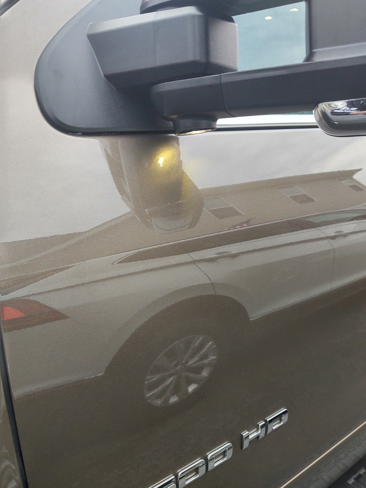

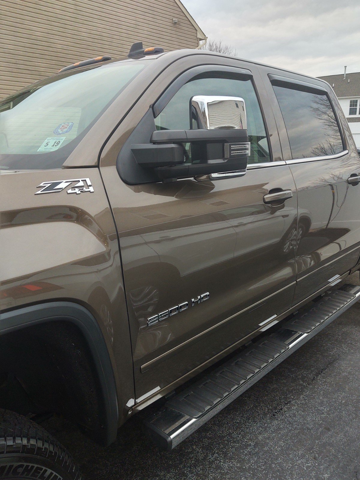

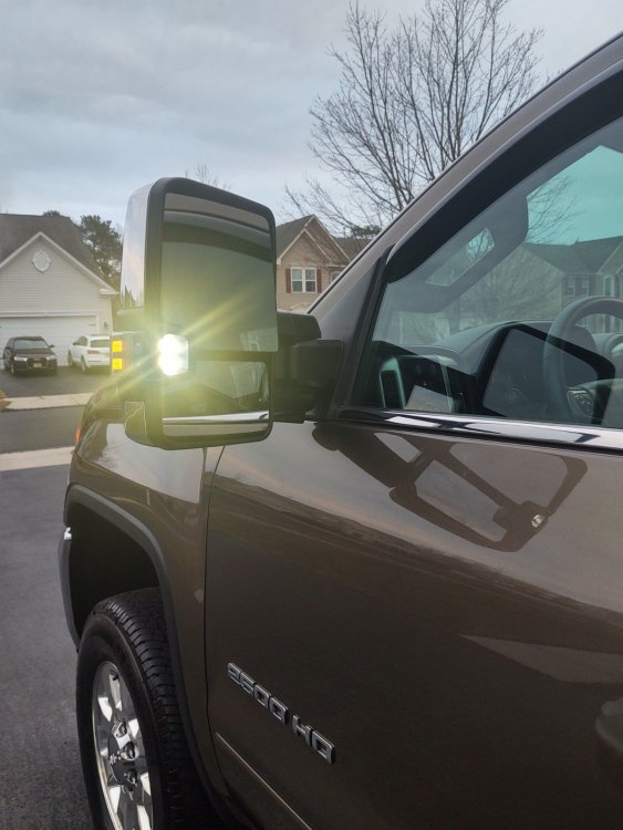

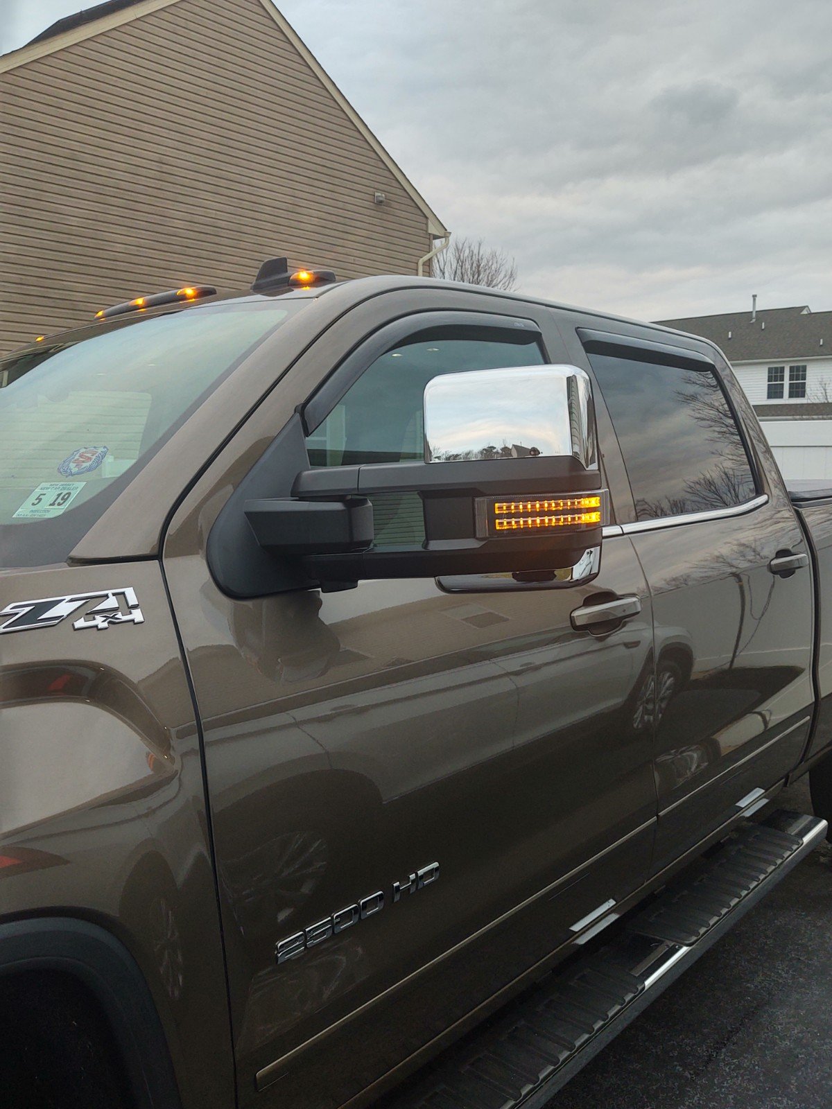

  5. Project #5 Completed,..... Mirrors installed and completely wired up. Big thank you to @pgamboa for the harnesses and the technical help, Much Appreciated..... Trail Ridge Mirrors - 1AMRP01790 Power Fold - Heated - Turn and Parking LED - Cargo LED - Puddle Lamp LED - OAT -

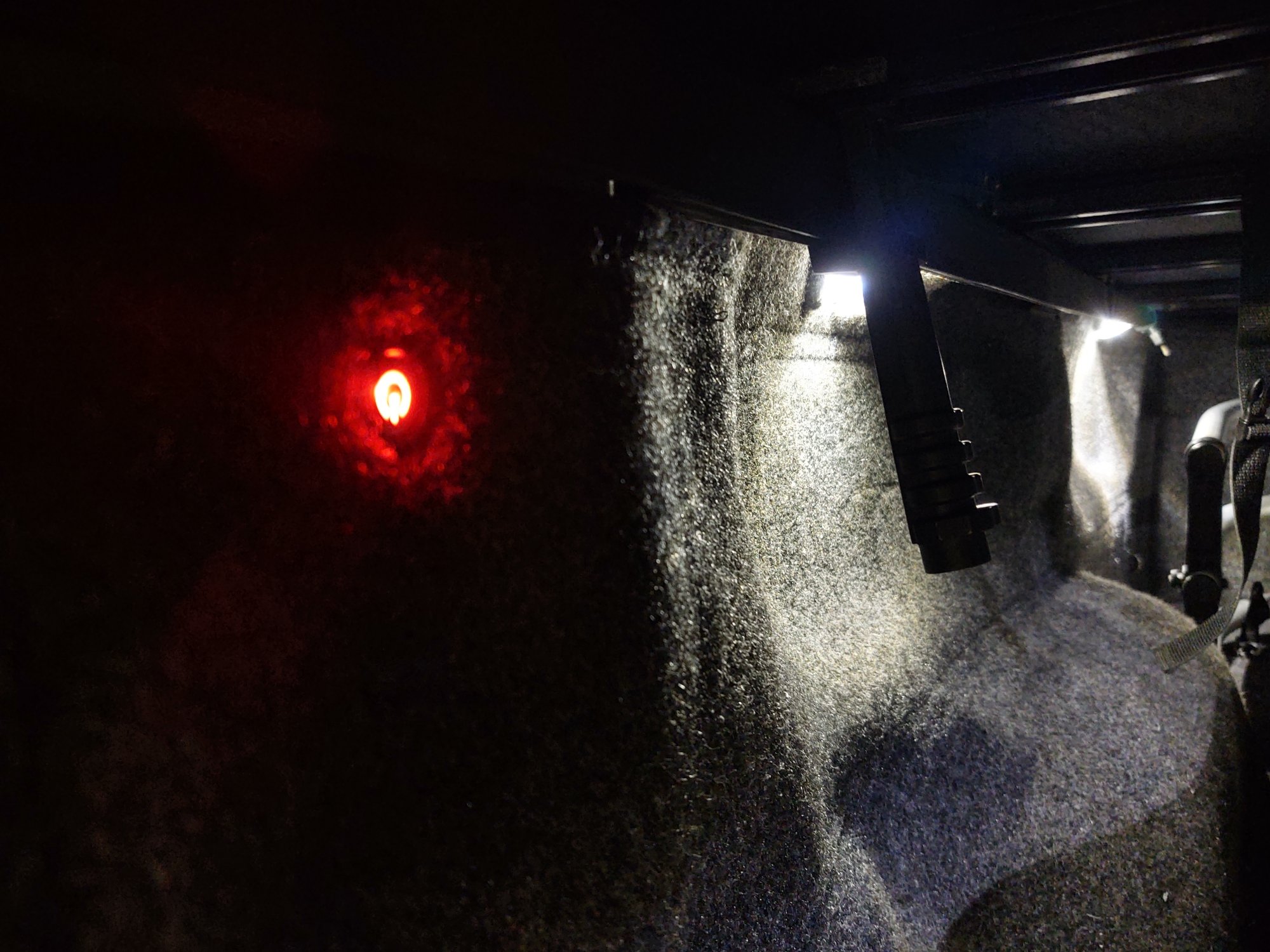

  7. I used the mod here from jaeisber as a guide. The second set of lights was a kit i picked up cheap from ebay for a $100. I wired and installed the switch first with the same color coded wire instead of using all black, an ran it down to the bottom of the truck first in the wire loom. I just wired in the second set of lights to the original set under the bed rail. Be careful. The light wiring (gauge) is super thin. I also found the 12v hot out of my hitch connection was the large black wire in my harness.. https://www.gm-trucks.com/forums/profile/203295-jaeisber/
  8. Few Projects completed this weekend. #3 on the list was that i finally got around to putting in the external lighted bed light switch and an additional set of GM bed lights. This is a must have,.. No more going in to the truck to turn bed lighting on..

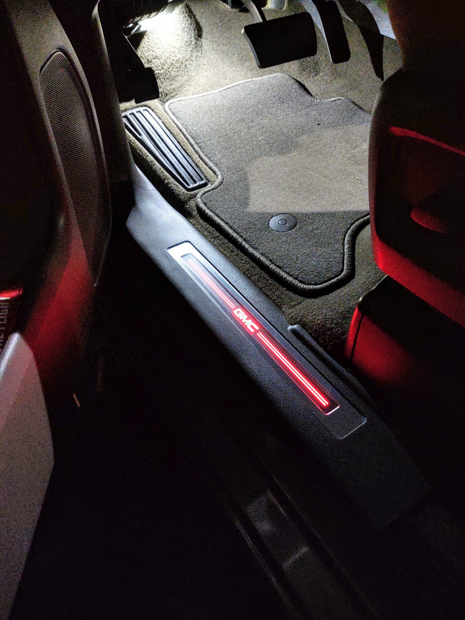

  10. Unfortunately not Black...Cocoa.. but 50.00 bucks.. was a no brainer.. 22933519 illuminated Door Sill Plates Cocoa Brown 2015 to 2019 GMC Yukon | eBay
  11. ebay... 22933519 illuminated Door Sill Plates Cocoa Brown 2015 to 2019 GMC Yukon | eBay
  12. Last weeks project....Finally Completed.
  13. Lighted Door Sill Plates,...Was too good of a deal to pass up...
