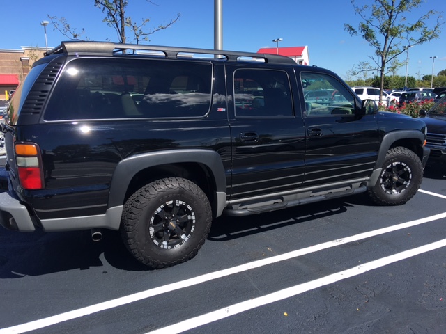

  5. Here's my '05 Suburban Z71. I installed a GM Goodwrench LQ9 6.0 with Black Bear tune about 1200 miles ago. I would like to do a 2" leveling kit, but I have to recover financially from the engine first, lol.
