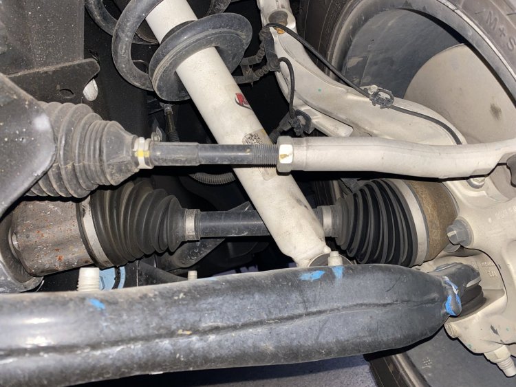

  2. Did your 2019 use the stock upper control arms? That angle doesn’t look good. Your 2020 kit looks ideal, but it should for the cost. Here is a pic of my 2020 with the RL level kit with new upper control arms. The CV angle is not severe like your 2019 was. This kit didn’t come out until 2020, so I am curious if maybe you used something different. This kit splits the spacers between the top and bottom of the coil over. Putting a spacer on the bottom of the coil over moves the control arm further away while leaving the ball joint and cv angle somewhat unchanged. I agree that lowering the front diff is the correct way to go to correct the cv angles. I must disagree with your comment that the upper control arm does not impact CV angles. The longer arms push the top of the spindle outward to help center the lower ball joint. This also changes the angle on the cv axle.
