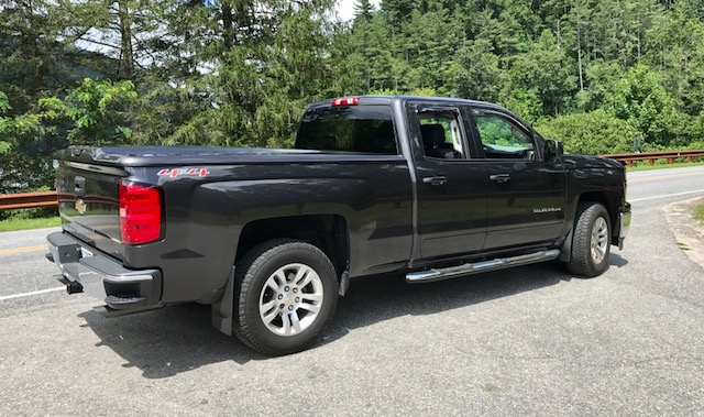

  2. This is how the Undercover Elite LX turned out . A little heavy on the coin but worth it . They're running a $100 rebate on it right now . Sorry the pic isn't great .

  8. Undercover Elite LX , painted to match . It has a great sealing arrangement , is secure , has a light and a retrieval hook (??) , Only drawbacks are it takes two people to remove / install , and it takes 3+ weeks to get it . Added the Rhinoliner spray in liner and McGard tailgate lock . The arrangement keeps my tools and camping gear safe and dry . Looks great too .
