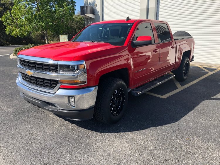

  1. Finally got my truck switched to new wheels and tires. Did Ultra Sports 203BM 18x9 - 12 offset, wrapped with Nitto Terra Grappler 12 and had a 2in RC level kit installed. I only have a rub at full lock and when I hit a slight bump on the back side of the tire. Will have to cut just the carpet liner if anything.

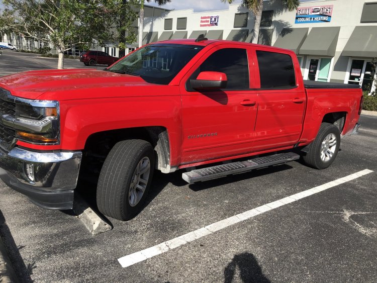

  2. I have a 2017 Silverado 1500 CC planning to put the 2" RC front level kit. Which set up would give me the more beefy look without rubbing or trimming? -275x65x18 or 285x70x17 As far as wheels, I'm thinking doing -12mm offset and 17/18x9. Help would be appreciated. Picture provided. My stock tires are due for tire change, so I might as well upgrade.

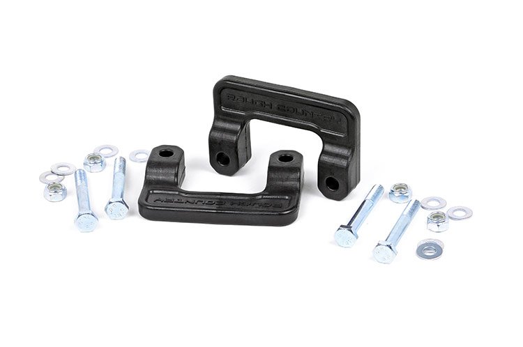

  3. After doing more research, Rough Country says going 285x70x17 with a -12mm offset is outside of the recommended specs and some did have to trim. Can anyone confirm this? I am only doing a 2in RC leveling kit, which is this one.
  4. I have a 2017 Silverado 1500 CC planning to put the 2" RC front level kit. Which set up would give me the more beefy look without rubbing or trimming? -275x65x18 or 285x70x17 As far as wheels, I'm thinking doing -12mm offset and 17/18x9. Help would be appreciated. Picture provided. My stock tires are due for tire change, so I might as well upgrade.

  6. Think I answered my own questions lol. I like 285/55/20 with 20x9 rims and 0 offset. Nice truck either way
