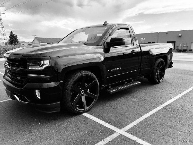

  1. Just an update, after three years in the making, finally i got my 275/35 r24 on a 4/6 drop.

  8. I currently have a 4/6 drop using 275 55 r20 (31.91 inches diameter) duratrac, winter season of course, with just enough to cause no rubbing at all. So I think with a 24 rim on a 4/6 drop, the ideal would be to use a 275 35 r24(31.58 in dia). Maybe to go for 285 35 r24 (31.85 inches) would make it close to the Ideal tire diameter of 31.91inches BUT maybe there is a risk now of rubbing on FULL turns due to widening the width close to 1/2 an inch. Of course 305 45 r22 would rub at 32.81 diameter, not to mention the 12 inch width already. Though, stance wise, it really looks nice. Pick your poison, if you will.

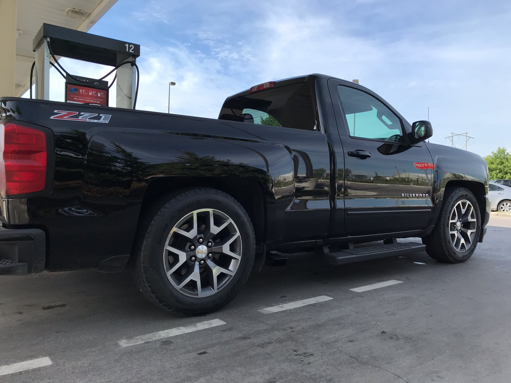

  21. 2015 SIERRA crew cab 4WD with Belltech drop shackle, I think it was part#6401. The rear is about an inch higher than the front. If you want it to be perfectly levelled, you may want to remove the rear leaf block too. It should give you another inch. Stock shocks. Though i I don’t have a picture on file, I used to lower my ‘17 Silverado reg cab 4wd with the same drop shackle and also removed the leaf block. I also used the canyon/Colorado ubolts (since they are shorter than the stock ). That set up was a perfectly leveled one. Stock shocks. Currently though, the reg cab is on a flip kit, drop spindle, drop strut set up. The only down side, I am currently using the 2212FF rear shocks which is too stiff for the regular cab. The nitro drop 2 is the one I think would be the better match in this lighter cab. just sharing my experiences for you reference.
