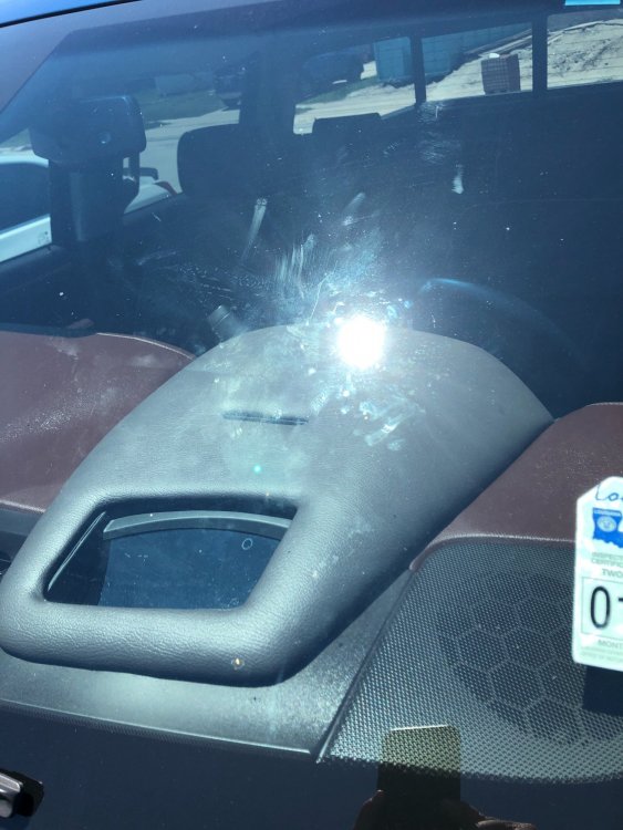

  1. Viktorrocks15 install is clean! He helped me with my install The total install minus the windshield was around $1700.00 That cost can be brought down a good bit. I think Viktorrocks15 was the first person to do the install. I did my install shortly after Viktorrocks15. The hardest part of pulling the dashboard was deciding to do it. I had maybe 10,000 mile on the truck at the time. If anyone is interested in doing the install and have any questions? You can message me directly. I have some parts that are left over. I will post all the pictures I have of the build

  7. The HUD reflection will show up on the regular windshield. It will be a little blurry and show double information. But it will work. The tint on the lower part of the windshield will solve that problem.
  8. That is the first guy rookie mistake. I cut the hood for the forward collision alert system. The High Country has a separate wire and light for the forward collision alert. Now I know the HUD will do that. That will not be on the future hoods.

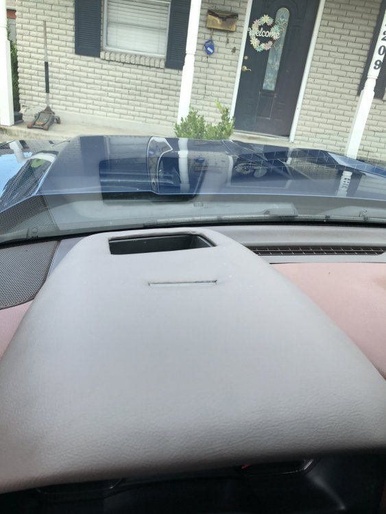

  9. I finally found someone to work with me on fabricating the Sierra/Silverado instrument hood. The fabricator set up an appointment with me for early next week. I will let you know how it goes

  13. I could not find anyone in my area to reproduce the instrument hoods for me. I am going to try and do it myself. I am using one of the instrument hoods I received from Viktorrocks15 as the template. I will update the forum ASAP
