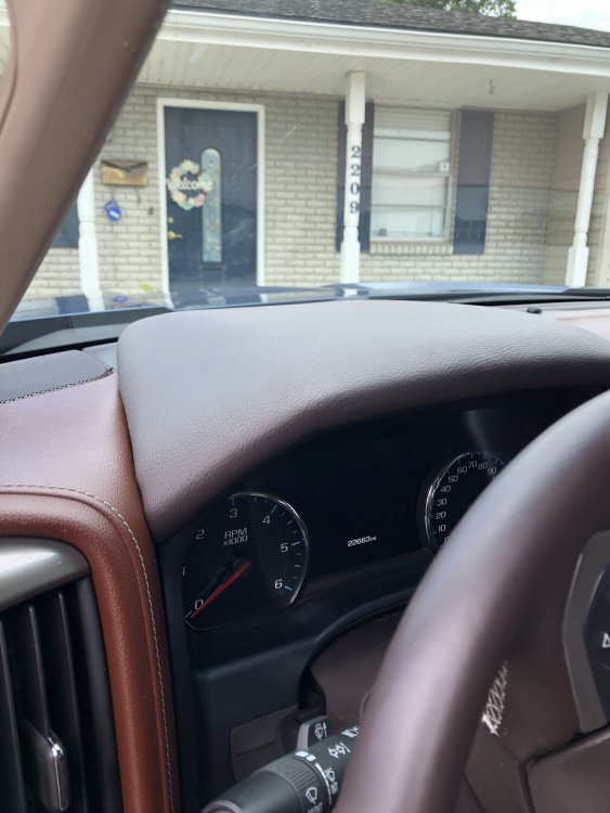

  1. Viktorrocks15 install is clean! He helped me with my install The total install minus the windshield was around $1700.00 That cost can be brought down a good bit. I think Viktorrocks15 was the first person to do the install. I did my install shortly after Viktorrocks15. The hardest part of pulling the dashboard was deciding to do it. I had maybe 10,000 mile on the truck at the time. If anyone is interested in doing the install and have any questions? You can message me directly. I have some parts that are left over. I will post all the pictures I have of the build
  2. It works great. I will try to post some pictures of the final product.
