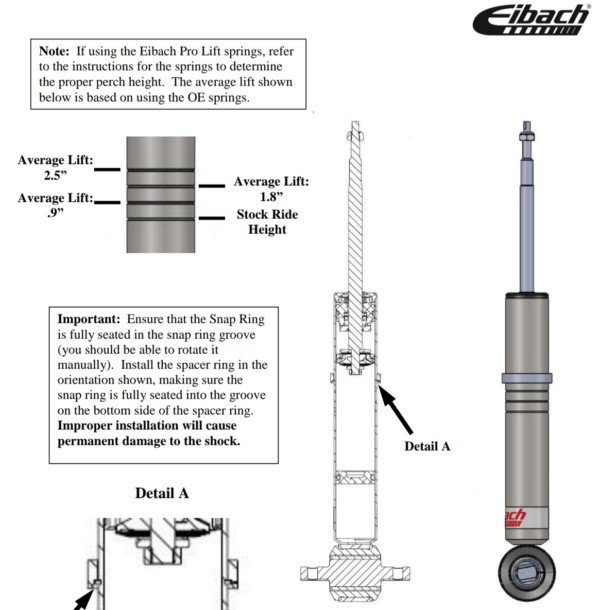

..I got around 2" on the third notch.. Eibach has updated their documentation since I installed mine..I was only looking for 1.5". They were originally underestimating how much lift would be achieved. Screenshot from their current documentation:
.. pull the trigger you won't regret it. I'm set on 3rd notch with stock springs.. night and day difference in ride and control.. especially towing.. gives me just the right amount of ground clearance for the winter driving around here.. I also bumped up to 275 60 20.. fills out the wheel wells better with slight rub on control arm at full lock only

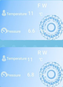

.. installed a set of BLE TPMS for motorcycle on the manual fill valve for my air bags.. now I can keep tabs on the bag pressure from my phone.. they are surprisingly accurate as well. -

..I aired down to around 5? now.. bounce is gone. I don't have an accurate measure for less then 10psi.. ordered a 1-20 psi gauge from Amazon -

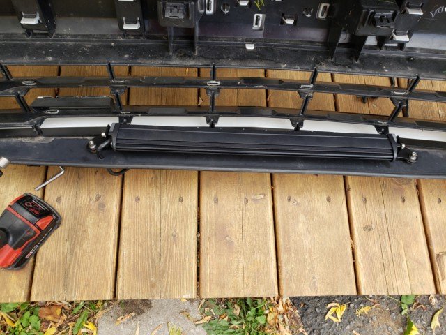

.. ok grabbed a couple night shots in my driveway of my yard.. the tent in the back is probably around 300' or so from where the truck is parked.. zoomed out so you can see it. Definately makes a difference in light output with the bar on..I pulled the relay fuse for the high beam shot without the bar. Not the brightest bar I've had by far but satisfied for a 20" 90W chinese bar that I got on sale $47CDN on Amazon. .. the install was straight forward.. used a 4 pin fused relay, 16ga power & 18ga control wires.. mounted relay directly behind right headlight with existing plastic plug.. ran all word thru PE split loom for protection.. trigger wire routed across front under plastic trim panel to left headlight and tapped white wire on plug with a Posi-tap (I live in salt belt and these work great). Pop off the grill - held with 4 10mm socket bolts and pressure clips.. used mounting tabs that came with the light bar to bolt down and used a couple oversized nuts to lift up the bar even with the lower grill opening. Grounded light bar with 16ga using a large bolt behind the bumper (there are plenty back there). Then wait until dark, hit the high beams and aim the bar thru the grill and lock down. -

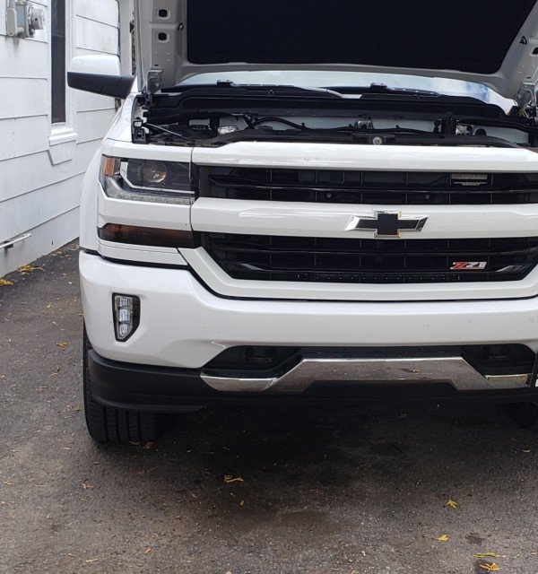

.. got my light bar all mounted up.. still need to connect the relay trigger from the high beams but everything else is wired and ready to go.. needed to take a mental break from the drivers side head light plug location before my blood pressure reached thermal runaway ?..I swear you need hands the size of a child to work on these things! Low profile bar mounts nicely to the grill Totally camouflaged from the front If you get right down and look thru the grill you can see the bar -

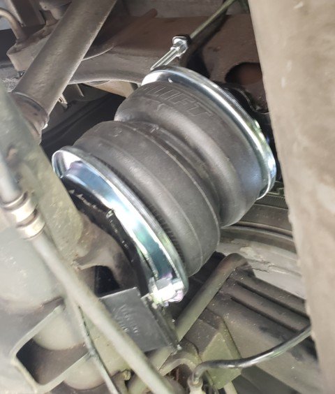

..lol maybe it's these trucks frame that's not plumb on the drivers side then! .. guess I'll pull the bag and verify the bracket on the surface plate before I call Air Lift ? -

.. got rear air bags in and got some driving time on them now.. ride seems to feel like a little more bounce to it.. running with around 10psi. Not impressed with the fit & finish of this Air Lift kit at all and the drivers side bracket had a slight bend/twist to it so the bag doesn't sit plumb.. no issue with the passenger side. Now the fun part to work issue with Air Lift next week to see if they stand behind their warranty. I chose Air Lift sure to their small footprint and their lifetime warranty on the entire package.. bags & brackets. -
