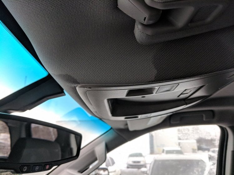

  3. We worked on it last weekend. We checked the wiring and try to remove the excessive rtv. However, after several attempts, it still says "signal may be blocked" . I refreshed the signal multiple times through the XM website, but the antenna did not pick up any signal. I ended up putting a new antenna. As soon as I connected it, "signal may be blocked" was disappeared . I finally got my XM radio working back after refreshing the signal with the new fin. It costs me overall over $100 to fix the stupid leak and to restore the signal: $10 for the clear RTV and the Caulking Gun $50 for the new antenna (part # 23258394) $50 for the labor cost that I paid for my technician friend If I were going to the dealer to handle it, they would charge me nearly $300 to reseal it.

  6. Thank you y'all of your help. My technician friend came last week and resealed the thing. We had to remove the headliner to have an access to the antenna. I used "GE All Purpose Silicone - Clear" to reseal the stupid fin. I hope the leak will stop permanently. However, I did lose my signal for the XM radio. It says "Receiption may be blocked". My just re-activated the membership and tried to refresh the signal multiple times, but still no signal. I'm not sure what is really the cause of the connection issue. We made sure every wire were properly re-connected. I suspect the antenna has been defective after the leaking occurred. Shame on you GM! trying to save some money to build and install cheap parts leading to major issues.
  7. Hello, My Silverado truck has about 120k miles and my warranty has already expired. It was raining all day long. The day after, I saw water drips coming out from the roof (see the attached photo). I went to dealer to find out where does the leak come from. They did water test and told me the leak from the Shark Fin. It costs over $200 to re-seal it. I asked them what would it cost to replace it, they told me it cost almost the same. I'm thinking to DYI the sealing, but I couldn't see any topics illustrate that. I'd appreciate any one can help me with this issue. Thanks in advance.
