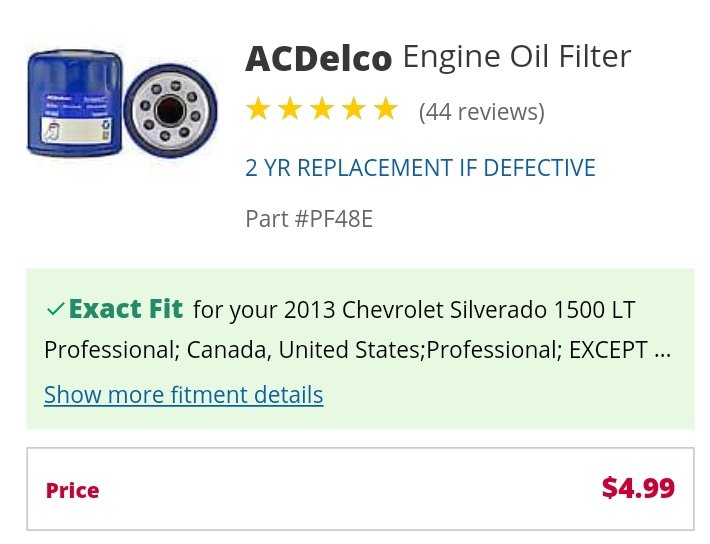

  1. I can find a PF48e for 4.99 but the PF48 is like $15. Is there a problem with using the PF48e?
  2. Can you please explain why you suggest PF63. PF48 is the recommended filter by Advanced Auto
